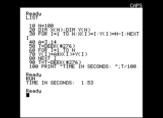

So, this is the SAXPY benchmark applied to the Oric Atmos 48K:

    In general, to prevent some delay from calculating the backward counting time difference I would suggest to save the ending timestamp first into a variable and do all calculations afterwards (similar like this: TE=DEEK(#276):PRINT "TIME IN SECONDS: ";(T-TE)/100. For sure, in this case the floating point expression evaluation in line 90 is negligible, but for comparable results on different devices without suffering from delays caused by the timing procedure this might be taken into consideration. – Johann Klasek May 02 '16 at 16:14
