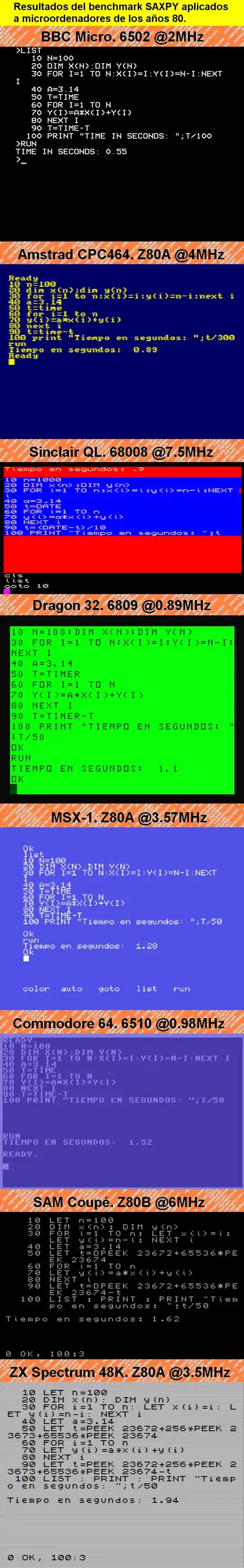

Some time ago, I benchmarked some 8-bit computers to find out the fastest BASIC interpreter. I ended up using the classic SAXPY benchmark, as I didn't want any I/O overhead to fool the measurement: printing on screen is slower for machines that doesn't have a real text mode and always operate in bitmap mode and it doesn't have to do with the BASIC interpreter itself. On the other hand, aritmetic routines play an important part in any BASIC program, so the benchmark does precisely that.
I'd like to add some other machines to this list, so I need to know how to measure time in frames (or equivalent resolution). For other computers, as you can see, the TIME or TIMER function is usually present in most BASIC dialects. For the Spectrum and the SAM Coupé, I already knew about the FRAMES system variable to count frames, but for others, I have to dig into technical documentation, which is not always available or easy to find/read.
Here is the current listing. NOTE: ("Tiempo en segundos" is the spanish for "Time in seconds").
The title says "Results of SAXPY benchmark applied to 80's classic computers".
UPDATE: thanks to Stephen Kitt answer, I can finally place the Atari XL, and it happens to be between the SAM Coupé and the ZX Spectrum.
As Stephen suggests, I will ask separate questions for finding out how to measure time for other micros.

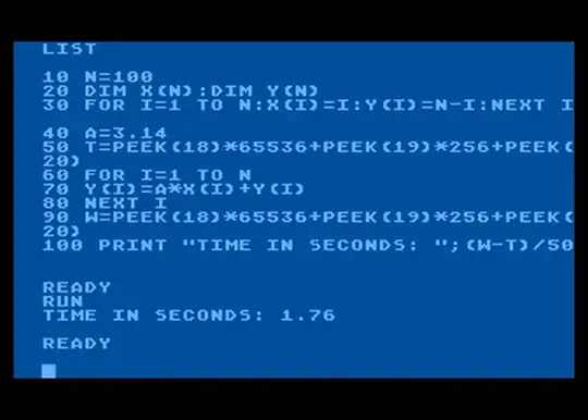

On the Atari 8-bit machines, you'd use the real-time clock memory locations starting at offset 18; these are updated during every vertical blank:
TIME = INT((PEEK(18) * 65536 + PEEK(19) * 256 + PEEK(20))/60)
(on an NTSC system; divide by 50 for PAL).
To measure your own time interval, the safest approach is to POKE all three values to 0 at the start of whatever you wish to measure.
See Mapping the Atari for more details and "links" to example programs.

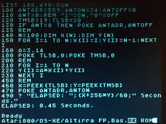

Here, actual screen shot with source, and proper way to reset timer and measure time... all run on 1979 Atari 800 (with Incognito board on Personality slot, enabling all available OS and Basic loads in existence, all the way up to XE/XEGS).
In reality, it is much faster than most of the samples posted here, even with Interpreter-based Basic on 8K rom-space):
Atari 800 / XE OS
Above results with Antic DMA turned OFF. If turned ON, result is 0.66 secs
Frank
  • Not quite seeing how this could be so much faster than the Atari version already posted. But the only other comparable machine with a 2 MHz 6502 is the BBC Micro, and its 0.55 s result is with system interrupts enabled – scruss May 24 '21 at 17:24
    The performance difference can be explained by the use of the Altirra FP performance pack, which provides floating-point routines that are substantially faster than the originals. – Stephen Kitt Jun 21 '21 at 07:57

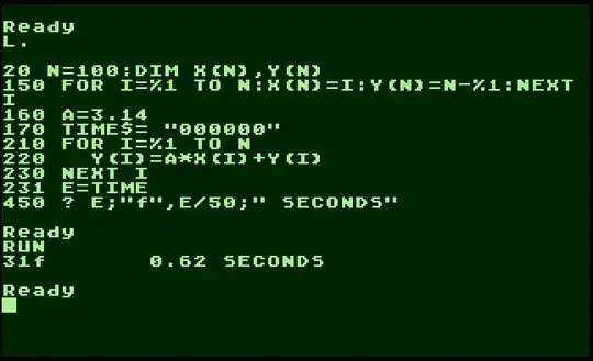

Here a screen shot with source on an Atari XL emulated by atari800 emulator with the good old german TurboBasic 1.5 by Frank Ostrowski from 1985.
This Basic dialect supports a variable time to get the 1/50 frames on PAL or 1/60 frames on NTSC systems. To reset this variable assign the String "000000" to time$.
Turbo-Basic runs only on Ataris with at least 64kb RAM. It uses the RAM under the OS and is ~18kb big. On a normal atari system it let you use 34021bytes. This Basic was a Listing of the month on Happy-Computer journal in 1985. Full compatible to the build in Basic on XL/XE but ~5 times faster. I love it.
