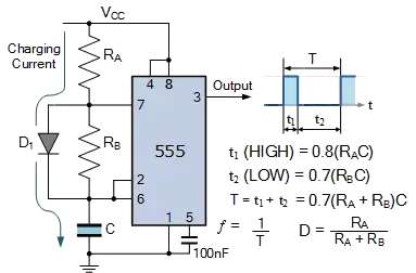

But on the main issue that I was pulling my hair out over, I think I found the problem. There appears to be an issue with clocking the Z80 too slow, which is somehow indeed causing some fluctuations or noise inside the CPU.
So, when I turned up the clock, I didn't get these problems any more.
I think it is known from 6502 NMOS technology too, they are not static, so you can't just stop the clock (or reduce the frequency under a certain threshold) and expect the registers not to get messed up.
And I have a confirmed solution for extremely slow clocking simply by keeping the clock line high most of the time and having fixed downward spikes. According to this picture:
(forget that diode D1 here, not using that)
Now I have Rb fixed to 1 kOhm and C is 1 uF. So we have the low phase a fixed 1 ms, hmm, that is 500 times longer than the maximum 2 us said it should be, but I don't have a problem with it. Don't have a scope either to actually measure it. My clock LED I removed because it looks like constant on, but I plugged the LED on the side of an inverter of the clock signal, and I see very brief flashing. I suppose 1 us I would not see, but 1 ms (or longer) I can see. (A homebrew computer needs blinkenlights after all.)
Anyway the Ra I have now adjustable between 0 and 1 MOhm. So it can be run really slow, like 1 Hz, and probably I could make it even slower to even stop the clock in this state and it will continue working reliably.

  • So I need to configure my 555 timer so that it does quick low phases and extends any period in the high state. I noticed that this uneven duty cycle happens with 555 timers. Just now I don't have a scope to verify that. – Gunther Schadow Aug 15 '22 at 19:31
    Jup, that's one way. Another would be to have the Arduino do the clocking. Software rules (isn't that the 6502 way?) Then again, just gift yourself a CMOS and you're able to do any speed :)) – Raffzahn Aug 15 '22 at 19:35
    Note that this isn't a case of "it happens not to work at low clock speeds... must be a bug". Almost all microprocessors /require/ a certain minimum clock speed, I think that the 1802 was one of the very few exceptions. – Mark Morgan Lloyd Aug 16 '22 at 18:35
