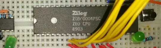

This is the CPU details, hooked to the EEPROM and the 555 Timer for generating 7Hz clock signal.

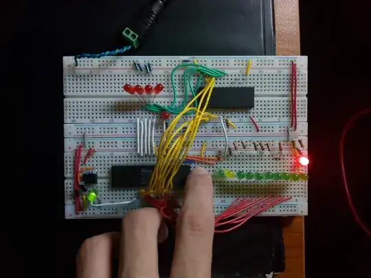

This is my full setup.

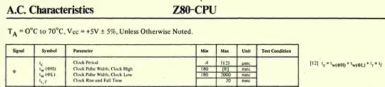

    What is your clock rate? You have NMOS Z80 chip, which is dynamic, i.e. it should have some minimal clock frequency, otherwise it WILL fail. As a simplest thing, swap that to Z84C0008 chip, which is CMOS and static. – lvd Jun 09 '20 at 14:53
  • @lvd I had to wait a full month to figure out how to get a Z80 CPU so getting a CMOS one is pretty hard on me :( but Is there a datasheet limit ? because As much as I searched I didn't find a value which is the minimum for clock speed..... Also the CPU can execute NOPs, HALTs JUMPs at the same clock rate so I don't think this should be a problem, or is it?- I don't know so I will not say that there is no problem in my Clock circuit. – Shams M.Monem Jun 09 '20 at 15:10
    @ShamsEl-Deen http://www.zilog.com/docs/z80/ps0178.pdf check this, page 34. Maximum width of clock=1 and clock=0 states is 2us each, so if your clock is slower than 250 kHz, NMOS Z80 will fail. – lvd Jun 09 '20 at 16:48
I/O port data should be latched by the I/O device on the rising edge of /WR signal. On the falling edge, the only thing that is stable is the I/O port address.
EDIT: just noticed you said you are clocking your Z80 at 7 Hz. By the picture you have posted, you are using a NMOS Z80 (Z0840004PSC. CMOS Z80s start with Z084C.....). These cannot work below the minimum clock frequency stated in its datasheet:
Z80 clock specification
The maximum allowable period is determined by equation (12), which yields 202.6 us, or about 5 kHz. At 7 Hz, the device will behave in unexpected manners, or won't work at all.
