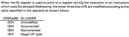

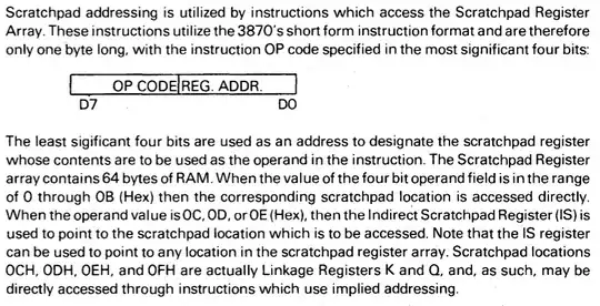

I also found another source confirming this, the Mostek 3870/F8 Microcomputer Data Book (the 3870 was the single-chip implementation of the 3850, and as far as I can tell they operated the same way):
And even more definitely stating that the opcode is indeed illegal:
