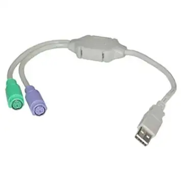

The easiest (PnP) approach is definely using two adapters. The first one should be a USB to PS/2 (miniDIN) adapter; This one needs to be an active adapter, such as this one: active ps/2 adapter
Avoid using weird smaller adapters like the one below - they probably won't work because they're designed for motherboards that have a PS/2 host, which allows them to be passive (motherboard will be in charge of changing D+ and D- from the USB port to Clock and Data signal from PS/2). If you have one lying around, you can always try it - your PC will be fine even if the keyboard won't work with this one. passive ps/2 adapter

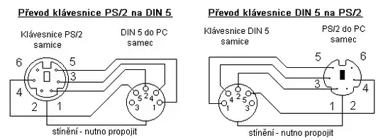

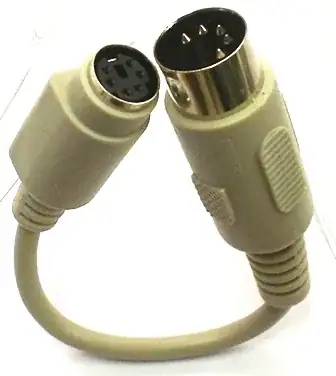

The second adapter should be a passive one; You can either make one yourself (working schematic on the last picture) or buy one like the picture below online.
passive din>ps/2 adapter a WORKING schematic
One last thing; If you're going to make an adapter yourself, you should not connect the same colored cables from the DIN cable to the same colored cables from the miniDIN cable; Always verify what cables you're connecting to what pins and double check if the polarization is OK (ie. that you haven't connected + from the miniDIN to a - on the DIN)

  • heh +1 for the Czech circuit images :) btw it works also in reverse I got USB keyboard connected to DIN5 Oscilloscope this way. – Spektre Dec 16 '17 at 09:42
  • A silly question, but is this schematics drawn as seen from the "back" (where the wires come in), or from the front (the pins)? – Violet Giraffe Sep 10 '19 at 20:19
    @VioletGiraffe From what I have experienced most of the wiring diagrams I have used show the pins as you look at the object, for a plug it's as you look at the pins as if you were 'plugging it into your eye' and for a socket it's shown as you look into the socket from the outside or 'down a well' so to speak. You just have to make sure the pins are numbered and so far all of the plugs I've ripped open had a small mark on pin 1 to show me which one that was, once you know which pin is which it doesn't matter what side you look from as the numbers for each pin are fixed. Sorry if that confuses a – Paddy Brett Nov 09 '19 at 17:51
  • @PaddyBrett, thanks for replying and that's a very good point that it doesn't matter if the diagram is mirrored as long as you know where to count from. – Violet Giraffe Nov 09 '19 at 20:54
