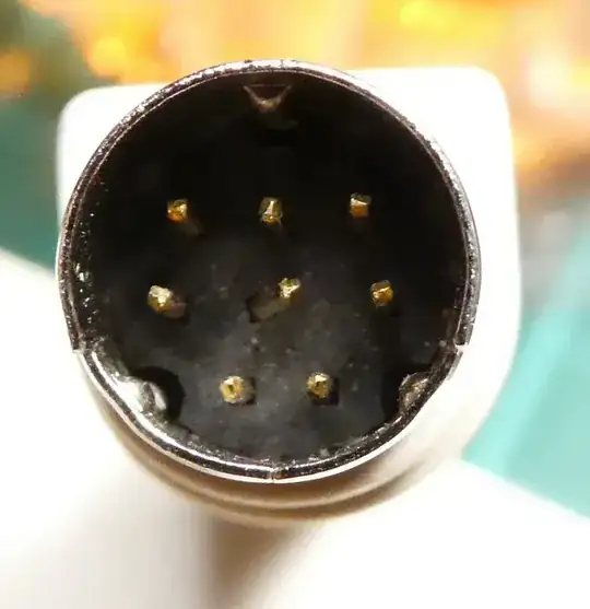

I have a vintage Sun Microsystems Type 6 keyboard that uses an 8 pin Mini-DIN and I want to use it on a modern computer with at least a USB 2.0 port. I've searched online e-commerce websites but most sell only PS/2 6 pin to USB adpatpers or converters. One site (Drakware) sells what I'm looking for but is unavailable (https://www.drakware.com/shop/p/sun2usb) and still awaiting a response from them. Here are photos for reference: Sun type 6 keyboard
8 pin Mini-DIN
Thanks in advance.

    @another-dave Direction is of importance here: There's no PS/2 (keyboard) to USB (Computer) adapters like that. The adapters you refer to are USB (Keyboard) to PS/2 (Computer) that will only work with keyboards that support both protocols. There are no computers to my knowledge that would support both PS/2 and USB on a PS/2 socket (but there are keyboards that do, the Sun one is none of them). The direction PS/2 (KB) to USB (Computer) is always an active converter. Unfortunately, the Sun keyboards aren't PS/2 (at least not the PS/2 a normal PC would assume), so we first need to go there – tofro Jun 01 '21 at 13:55
  • The PS/2 6pin mini-DIN (keyboard) to USB (computer) active converter is pretty straightforward; i'm typing on the setup right now. This 8-pin Sun keyboard is definitely going to need an active converter to USB. Problem is the vendor. I'd like to avoid going through an arduino setup if I can. – Homberger Jun 02 '21 at 10:53
