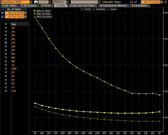

Option implied Vols frequently exhibit very pronounced smiles (IVOL for far OTM options are significantly larger compared to ATM), meaning they imply different vol processes. Quoting from Just What You Need To Know About Variance Swaps - JP Morgan Equity Derivatives
For each strike and maturity there is a different implied volatility which can be interpreted as the market’s expectation of future volatility between today and the maturity date in the scenario implied by the strike. For instance, out-of-the money puts are natural hedges against a market dislocation (such as caused by the 9/11 attacks on the World Trade Center) which entail a spike in volatility; the implied volatility of out-of-the money puts is thus higher than in-the-money puts.
Implied vol is also not directly related to historical vol (the vol of the underlying) for at least two reasons:
1 ) Empirically, IV tends to overestimate RV, commonly referred to as Volatility Risk Premium
2 ) IV is the only free parameter in the Black-Scholes-Merton (BSM) model. Higher IV can be a result of compensation for tail risk.
For example, if you look at GBPUSD, you have Brexit as a major event. Uncertainty meant that IVOL not only anticipated the higher realized / historical vol, but also meant that it was heavily skewed towards OTM Puts (on GBP). Below is a screenshot of the smile on the day of Brexit and during normal times.
