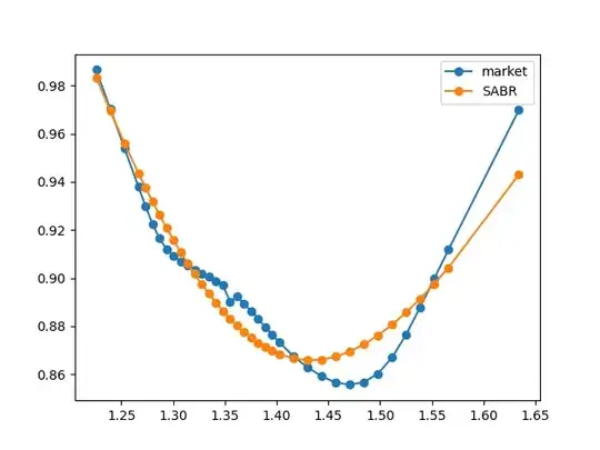

I am trying to calibrate SABR but I do not fit the given volatility.

Well, it looks pretty good to me. The SABR model has only 4 parameters and there is only so much you can do with them.
If you have a lot of volatilities, especially if they have a quite irregular distribution, like in the picture, this is what you can expect when trying to fit the SABR model.
