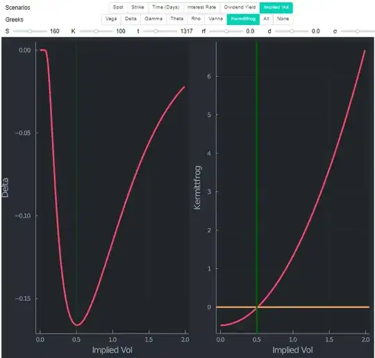

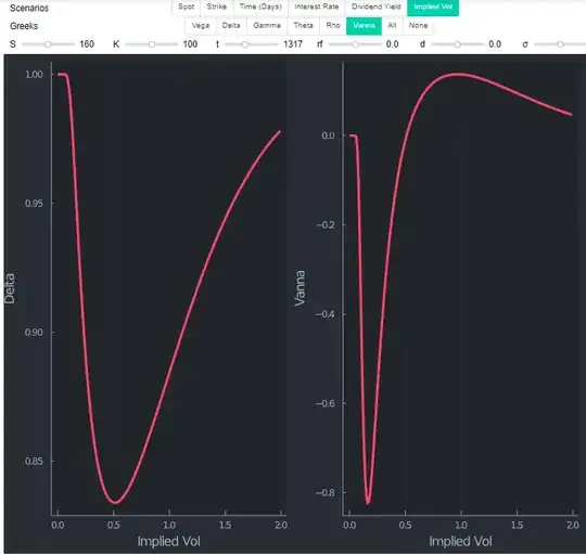

Adding a few remarks to @Kermittfrog's excellent answer. If you plot delta and the condition derived by Kermittfrog as a function of vol you can clearly see the relationship. The right-hand side in the plot below is Kermittfrog's condition $1/2*σ^2*t - log(S/K)$. The yellow line determines if the change in $\delta$ is positive or negative as a function of $\sigma$ (in this specific example of being long an OTM put). "Kermittfrog indicator" below 0 means declining delta and vice versa. The green vertical lines are just for convenience to show that it is indeed the minimum of $\delta$ where its sign changes (left-hand side). The charts below are produced with Julia.

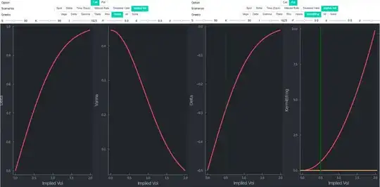

Looking at a call with the same strike (hence ITM now) shows that $\delta $ is looking similar in shape (not in actual values obviously). I added Vanna (dDeltaDvol) which measures the rate of change of delta concerning changes in Vol for convenience in this chart.
However, neither OTM call nor ITM put exhibit this pattern. Also natural, given $1/2*σ^2*t - log(S/K)$ depends on the second term (all else equal). When $S=K$, $log(S/K)=0$. Once $S<K$, $log(S/K)$ is negative. Hence, both terms are strictly positive (you subtract a negative value) and vol is positive in any case.

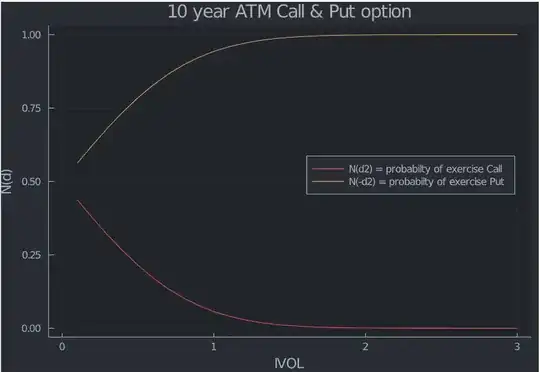

Almost there, no worries. $N(d2)$ is the probability that a call option with an exercise price of $K$ is exercised in a risk-neutral world. Therefore, $(1− N(d2)$ or $N(-d2)$ is the probability that a put with the same exercise price will be exercised. Let's plot this as a function of vol.

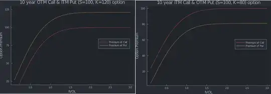

How about the premium of puts and calls?

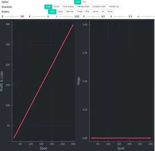

Getting stranger and stranger isn't it? Even though there is supposedly zero probability of exercise for a call, I still pay a maximum that seems to be the current spot price, irrespective of the strike. I will provide another explanation using $N(d1)$ a bit further below after the PDF of the normal distribution. For the put, however, the maximum is reached at the strike price itself. Explained intuitively, a zero strike call has no vega and does not change when vol is increased to infinity.

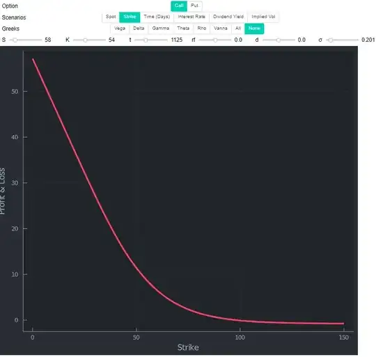

At the same time, call option prices are decreasing, as a function of strike (see next chart). Thus, the maximum value a call option can have is that of the zero strike call (which is the price of the current spot when there are no interest rates and dividends). For puts, a similar argument can be made that leads to the strike being the maximum value. I link an answer/explanation where the question is flawed (delta is not the probability of exercise) but the accepted answer is correct.

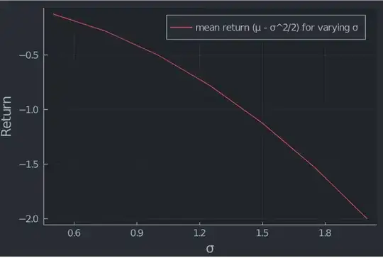

Also, as seen above, expected returns decrease. This can also be demonstrated by plotting the normally distributed returns.
