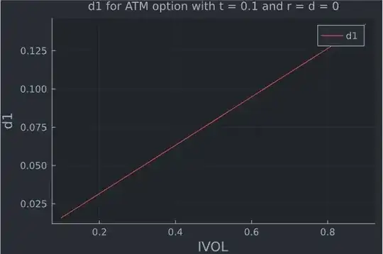

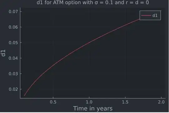

With dividends, $$d1 = ( log(S/K) + (r - d + 1/2*σ^2)*t ) / (σ*sqrt(t))$$ which is identical to $$d1 = ( log(F/K) + 1/2*σ^2*t ) / (σ*sqrt(t))$$ because the forward is computed $F = S e^{(r-q)T}$
Using this, setting $r = d = 0$ will result in delta being > 0.5 for any time $t$ and implied vol $\sigma$ that is > 0 (hence all the time). This comes from the fact that if $d1 =( log(F/K) + 0.5*σ^2*t ) / (σ*sqrt(t))$, you can see that for 100% moneyness, hence $F=K$, $d1>0$ which means it is above 50D which corresponds to N(0.0). It is an increasing function of vol:
and the term $$\frac{log(\frac{F}{K})}{\sigma\sqrt t}$$ in d1 converges to 0 as $t \rightarrow \infty$ (the larger vol, the quicker it converges), which leaves us with $1/2∗σ2∗t$ which in turn is growing withough bound in $t$ and $\sigma$.
