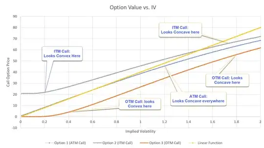

I think it's interesting to look at this problem graphically also. I get a different answer, depending on whether the option is ITM, ATM, or OTM. In the plot below, all options have 1-year expiry, rates are set to 0.01 and spot is 100. The ITM call has strike 80, the ATM call has strike 100 and the OTM call has strike 150. I added a linear function (y = 40* vol) for comparison in yellow colour. This is what I get:
For completeness, we can show that the ATM options are concave for all values of IV, as the chart above alludes to:

To add to @Jan Stuller answer , ATM options are pretty close to linear in volatility in the BS model (and exactly linear in the normalized Bachelier model). Options away from the strike are positively convex in volatility (note that OTM vs ITM makes no difference , just distance from strike). The exception is that in BS at very high lognormal vols, there is some negative convexity due to the fact that call prices are bounded in the upside by the stock price. In normal models OTM options are strictly positive convexity in implied vol.

  • Yes, the ATM call looks pretty linear all the way to IV = 100%. But judging by how it slightly crosses the linear yellow line in this range, it might be ever so slightly concave nonetheless. – Jan Stuller Oct 18 '20 at 17:25
