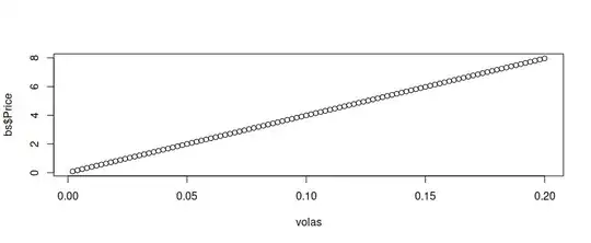

  3. We can compute a bunch of option values and plot the result:
library(ragtop)
volas <- (1:100)/500
bs <- blackscholes(
  callput = 1, # 1 for calls, -1 for puts
  S0 = 100,
  K = 100,
  r = 0,
  time = 1,
  vola = volas
plot(volas, bs$Price)
line(volas, bs$Price) # More about this below.
Call:
Coefficients: [1] 0.002874 39.836173
Almost linear plot

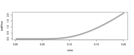

Hmm, what about points 1 and 2. This looks linear... What's up with that. Let's try some other parameters:
bs <- blackscholes(
  callput = 1,
  S0 = 100,
  K = 120,
  r = 0,
  time = 1,
  vola = volas
Less linear plot
The relation is certainly not linear but can appear linear locally. Also see this answer for different plots or play around with the R code above.
