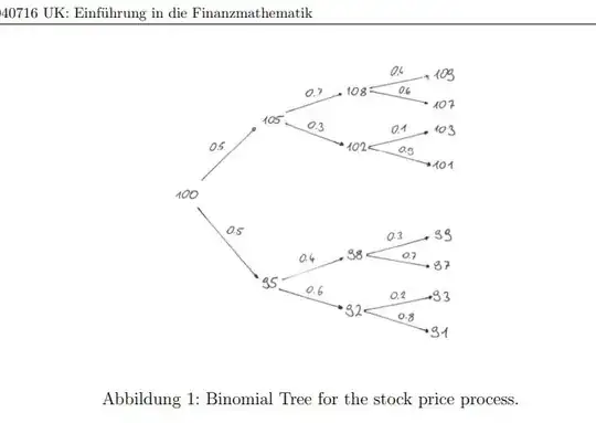

Figure 1 describes the stock price process (St) for t = 0, 1, 2, 3 by a binomial tree. The aim is to price a European call option with strike K = 100 whit maturity T = 3. Assume further that the interest rate is constant to zero.enter image description here

  • Do you know exactly what a "node" represents? Is it some combination of time period and stock price level? Does each node have only one "predecessor" ( a non-recombining tree) or can it have multiple predecessors (a recombining tree or lattice). Do you have a diagram of what the tree looks like? How many "terminal nodes" are there? The answer below (super-replication) is on the right track, but some details in the problem statement remain unclear to me. – nbbo2 Jan 11 '20 at 15:45
    @noob2 Ive edited my post and post the entire worshsheet so its more understandable. Greatly appreciate your comment. – Lion Heart Jan 11 '20 at 17:57
This is kinda 'super-replication'. You want to find the minimum amount $w$ that you need to invest such that a portfolio of $x$ amount of bank account and $y$ units of the stock, which costs less than $w$ initially and which you can dynamically adjust subject to no new injection of money ($x_{n-} + y_{n−}S_n ≥ x_n + y_nS_n$), returns at least the option payoff at maturity.
