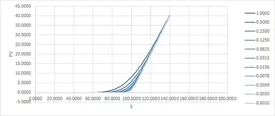

Let's look at an example, just a vanilla call. K=100, r=q=0 (i.e. no drift, fwd is whatever the spot is), $\sigma$=20% (changing the vol. in all these examples will just be like changing the time, so it doesn't really make a difference to the answer). Below, adu is absolute delta/unit, and aguu is absolute gamma/unit/unit.
note how as the time goes to zero, the payoff approaches a cusp. Here are the delta and gamma:
Now, i think it's fairly easy to see that as $t \to T$ this becomes unmanageable to hedge.

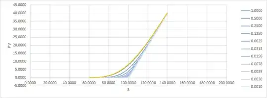

One method to deal with this is to break up the option into several, with different strikes spread around the original one. Here's what that looks like (with the $t=1.0$ pv overlayed in orange for comparison): enter image description here
and here's the difference in price as time goes on:enter image description here

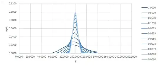

Okay, so delta and gamma? enter image description here enter image description here
So the delta has an extra step in the middle, and the gamma is still spikey, but now each spike is half the size of before. Obviously we can do better still.

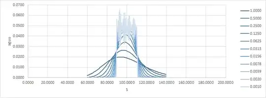

Let's do a strip of options spread from 90 to 110.
Here's our new payoff, and the comparison to the original: enter image description here enter image description here
And again, delta and gamma: enter image description here enter image description here
So, you can see that by spreading out our payoff, we can reduce the potential risk we may face in the future, with only a minimal increase in cost.
