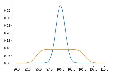

The gamma of an option as it approaches the expiry date becomes ill defined at $S_T = K$. However, if you approximate your option sitting at $K$ as a set of options with strikes ranging from $K-\delta_K$ to $K+\delta_K$, what you're doing is limiting the spike sitting at $K$ and replacing that whole gamma for a wider one sitting along all those strikes.
Here's just a toy example on how that looks when you replace the gamma of an option with strike $K$ to ten option of strikes from 95% to 105% and 1/10 notional. You can just plug in the BS formulas (for price and gamma) and reproduce it in python easily.
