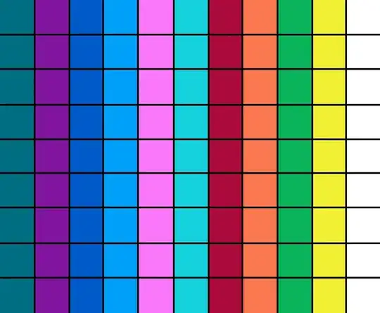

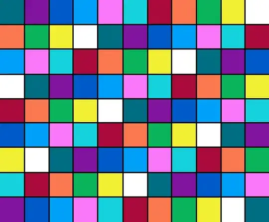

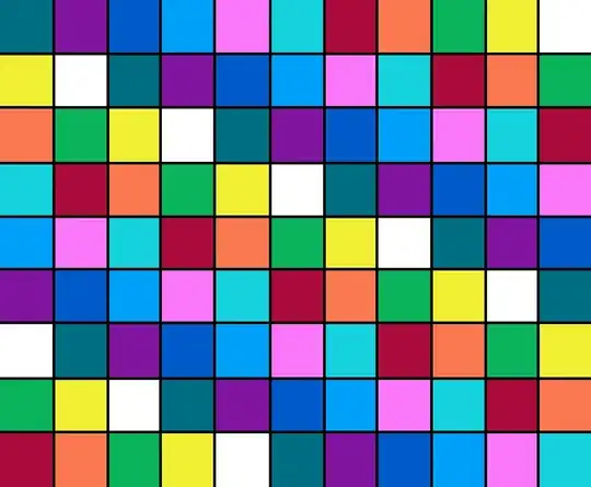

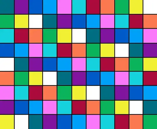

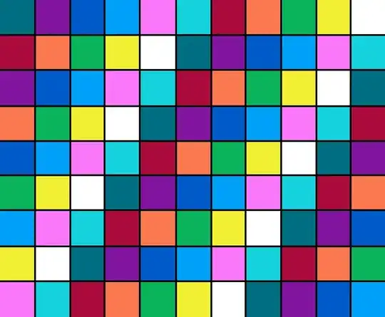

Perform
66
tests of nine sheep on all but one sheep according to the illustrated patterns:
The two important properties exhibited are
1. All but one sheep are tested six times.
2. No pair of sheep shares more than one test.
The claim is that given a set of test results there is at most one possible group of five wolves. Suppose instead that some set of test results could have been produced by two different groups of five wolves A and B. Then both groups have a sheep that the other group does not have.
By property 1, at least one of these two sheep was tested six times, say Shaun in group A. Group B must have at least one of five sheep in each of these tests. By the pigeonhole principle, at least one sheep in Group B shares more than one test with Shaun, contradicting property 2.
This establishes the claim. Because we know there are five wolves, this guarantees that we can determine them using the test results.
UPDATE: We can remove any single test T to improve the total by one. Say Shaun is in group A but not B, and Shirley in B but not A.
The argument above only fails if neither sheep was tested six times, i.e., each was either in T or untested. By property 1, one of them, say Shaun, was in T and still tested five times. Because Shirley was either in T or untested, Shirley cannot appear in any tests with Shaun by property 2. Then Shaun's remaining five tests must be accounted for by the remaining four sheep of group B, which fails as above due to the pigeonhole principle and property 2.
UPDATE 2: We can save two more tests by replacing any one of the grids of eleven tests with a grid of nine tests along the rows:
bringing the total number of tests down to
63.

    Seems convincing to me. Any idea how this could relate to OP's hint about binary representations? – Ergwun Apr 17 '19 at 14:15
  • @Ergwun No idea. – noedne Apr 17 '19 at 14:26
    Suppose your method failed to distinguish actual-wolf-grouping (a,b,c,d,e) from incorrect-wolf-grouping (a,b,c,d,f) — that is, sheep f is innocent — so, each of f's tests must have contained one of the actual wolves (a,b,c,d,e) in order for the frame to stick — which is impossible because f was tested 6 times and there's only 5 of (a,b,c,d,e). OR ELSE, f must be the one untested sheep! How does your logic rule out that possibility? – Quuxplusone Apr 17 '19 at 16:31
    @Quuxplusone If you take two different groups of five wolves, then each must contain at least one wolf that the other does not contain. In your example, e and f are the two "sheep that appear in one group but not the other." So you may not be able to take one of them (f), but you can still take the other (e). – noedne Apr 18 '19 at 00:03
    @noedne: Ah, I half-suspected that that was what you meant. (Personally, I would have said that there is one "sheep that appears in one group but not the other" (namely f); sheep e appears "in the other group but not in the one.") Okay, I think I see it now. Either f was tested six times, or e was tested six times. We choose the one who was tested six times, and call him Shaun, and proceed as you wrote. I think I see it. :) – Quuxplusone Apr 18 '19 at 00:12
    @Quuxplusone Thanks for pointing out the poor wording. Hopefully it is better now. – noedne Apr 18 '19 at 00:18
    Can you also explain why this technique wouldn't work if you split the sheep into 10 groups of 10 with no leftover sheep, and ran 6x10 = 60 tests instead of 6x11 = 66 tests? I suppose the problem "Partition 100 sheep into 10 classes in 6 different ways such that no two sheep are in the same class in more than one of your partitions" is unsolvable, but how do we know that? Did you just stumble into a solution to "Partition 99 sheep into 11 classes in 6 different ways such that no two sheep are in the same class in more than one of your partitions" or was there a method to your madness? – Quuxplusone Apr 18 '19 at 18:56
    @Quuxplusone The construction takes advantage of the primality of 11, which ensures that distinct lines of tests intersect at most once but fails for composite numbers like 10. – noedne Apr 18 '19 at 23:22
    @noedne, This is really impressive work. – wanderer Apr 19 '19 at 18:35
    FYI @noedne, I have asked for more information on the math underlying your solution on math.stackexchange here: "Partition a set into g groups, k different ways, such that no pair of elements is ever in the same group together more than M times?" – Quuxplusone Apr 21 '19 at 00:10
    I have verified this solution using C# code and found out that all possible 75287520 arrangements did indeed produce different 66-bit results. – Razvan Socol May 05 '19 at 14:44
  • Your coloured squares remainds me on "rainbow tables", not a surprise – z100 May 05 '19 at 20:25
  • I verified your 2nd update, 63 tests works. I also strongly feel it is the optimal answer, and tried explaining why I feel that way in my answer below. Regardless of that being the case, coming up with this answer is extraordinary. – Skosh Jun 05 '19 at 17:39

@noedne's answer from the beginning struck me as a good one, but I have recently come to the conclusion that it is also the optimal answer. I'll be first to admit that I don't understand everything going on, but I feel the need to at least try and explain it.
The basic strategy that yields the 99-test solution isn't complicated. We don't want any one test to have any sheep in common with any other test, thus one test per sheep. We get to use 99 tests instead of 100 because the last test becomes moot.
The advanced strategy is to let us allow tests that have at most 1 sheep in common with any other test. Not just that, but we still want tests that have no sheep in common as much as possible. @noedne made a set of patterns that did this. Each block represents a set of tests that have no sheep in common with eachother. Beyond a single block, no two tests would have more than a single sheep in common.
The next strategy up would be to allow at most 2 sheep in common between tests... this is where I was dabbling for a while until I realized how ineffective it was. Clearly, it isn't preferred for 100 sheep.
Assume, then, we want to optimize the "at most 1-sheep in common" strategy. The place where it is most "powerful" is when the blocks are square and they cover every sheep once. Technically, that's "every sheep except one" because it ends up being okay to always leave one sheep out of the testing. I'm having trouble explaining why being "square" is optimal, but it seems obvious having played with it for a while.
Next, how many test blocks do we need before the combinations become unique? Again, I don't know why, but the answer is definitely based on how many wolves the problem contains. Every time you add a wolf to the mix, you need an additional block to make the combinations unique. If you never experimented with other #'s of wolves you may never have noticed.
Additionally, as @noedne noted in the 1st update, you don't actually need the last test you run. It ends up being moot, exactly like it did in the first, simple, strategy. Why? I have no idea, but I suspect magic.
So this is how I fill in the chart representing best-possible scenarios. The blocks are square, so sheep per test = tests per block. We always need one block more than the # of wolves. Then the # of tests we need to make unique combinations is tests per block x required blocks - 1. This chart only includes prime numbers of sheep per test because that's what @noedne's pattern works for. None of these scenarios reflect the "100 sheep" condition we are given in the question, but for their respective sizes (max sheep) they must be optimal because everything is as good as it could be.
You maybe noticed that for small test sizes the required tests are actually worse than what the simple strategy would have given you. That means we know there's a cutoff for where the advanced strategy is better. (This is why I suspect there's also a cutoff for when the third strategy would be better)
So we can adjust the # of wolves in these smaller cases to something smaller, and then the 2nd strategy becomes best again. This is nice to know because it makes for some puzzles you could try by hand, instead of trusting a computer program.
So here's where things get interesting. The 11x11 blocks would allow you to solve a 121-sheep problem using 65 tests. Sounds familiar? That's @noedne's answer after his first update. But we see it is inefficient, because there's a theoretical 10x10 block good for 101 sheep, and it will solve in 59 tests. The problem is that 10 isn't prime and @noedne's pattern doesn't work for it. @noedne's pattern isn't itself a requirement, though, and we shouldn't exclude the possibility that 10x10 could still somehow work.
But getting 6 blocks of 10x10 tests is quite impossible, according to the requirements of the 2nd strategy: tests within blocks have nothing in common with each other, and tests from anywhere have no more than 1 sheep in common. I can get 3 blocks of 10x10, and maybe I would believe somebody could get a 4th block with enough effort... maybe. It isn't enough either way and that's why 10x10 blocks will never be a reality. I would comfortably say 59 tests is the lower bound, however, since it would have been optimal if it were possible. Edit: It seems that OEIS A001438 nearly confirms that 10x10 doesn't work for us. There is a conjecture on that page that a(10) = 2 which would translate to 4 total blocks for us.
So lastly we need to address @noedne's 2nd update. The gist of it is that @noedne was using 9x11 blocks, which covers the required 99 sheep in testing. This also means an 11x9 block would work as well. @noedne swapped out just one block, and it didn't break the requirements. I used my program to test this idea, and it does indeed check out.
If you could show that a second 11x9 block could be swapped without breaking the requirements, then the total tests would drop to 61... a not unbelievable number. Even if you managed it, at some point you would lose definition, after all the theoretical 9x9 block scenario isn't itself good for 100 sheep.
That's everything I've got. I know it has lots of holes, and maybe somebody could help me fill them if they were interested. A lot of this is beyond my reasoning. I think I'm burned out on it now, so I'm going to stop.
