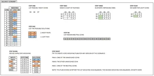

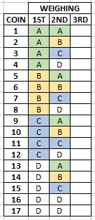

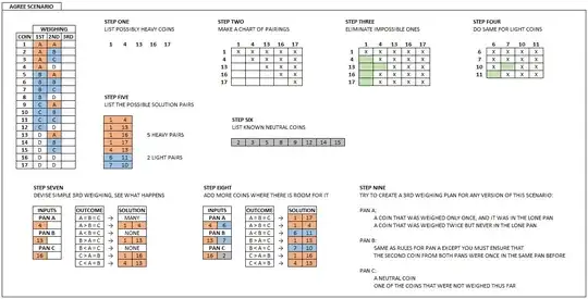

The right perspective to have in order to get the most out of this balance is to think of all the combinations the counterfeits can have for the "solution". Coins #7 and #9 are heavy... Coins #3 and #11 are light... there will be many of them. When you use the balance, it is going to eliminate some of these combinations from what is still possible. If I set up a bunch of coins on the balance and I see pan A go down, any combination that says pan A contains a light coin must no longer be possible. Happily, every time we use the balance it actually removes a bunch of the possible solutions.
So think of it like this: When you arrange coins on the balance it's the same as taking your "solution combinations" and putting them into seven piles, each pile corresponding to an outcome. When you read the actual outcome of the balance, you are able to say that one of the seven piles is still possible, and the other 6 piles are impossible. That's why @A. P. claimed you have 343 maximum configurations, because one weighing could divide that into 7 piles of 49. A second weighing could divide each of the piles of 49 into piles of 7. The third weighing could divide each of the piles of 7 into a pile of 1, representing that you have found a single solution to the puzzle after three weighings.
But, of course, that number assumes you can divide the combinations into seven equal piles. As it turns out, on your first weighing, the six imbalanced outcomes are always equal but that balanced case (typically) is a different number.
When we try to solve the 19 coin puzzle, there is no way to make a first weighing that makes piles of 49 or less. How do you know what piles are what sizes? I'm not getting into it here but there's equations for it. I did it by hand for small numbers of coins and worked my way up until I saw the patterns.
So next up is the 18 coin case. This one is going to fail at the second weighing, not being able to make piles of 7 or less. @ppgdev claims to have found a counterexample to this statement which probably means I have forgotten something. Maybe the correct statement was that there's basically one way to make piles 7 or less but we can exclude it because it fails for a different reason? This was the part of the problem that made me say I don't quite have a "proof" for the answer. I also used a computer program to sweep this area and make sure I didn't miss anything. The me from 4 months ago was convinced 18 coins couldn't work, for whatever that's worth.
The 17 coin case is possible, so let's focus on that.
4 coins per pan gives us the least maximum combinations in any given outcome. You may not know that an adaptive strategy works better than a preplanned one, but I assure you after a few weeks on this problem you'll agree with me. Even though that's true, the information we get in the first weighing isn't enough to make any clever adaptive strategy in our second weighing. It turns out we just want to do the same thing again (4 coins per pan), just making sure to jumble up the coin's positions. Remember, we want to divide the combinations up again, and keeping coins together will only hurt us in that regard. Here's my notation for the first two weighings:
There are 49 different ways this arrangement could go, but luckily most of the cases boil down to the same thing. I get 3 scenarios that effectively cover the 49 cases.
The first case is where one or both of the weighings balanced. It should not surprise you to find out this is solvable, since someone already solved something harder. The other two cases I call the "agree scenario" and the "disagree scenario." One pan went down in each weighing? That's the agree scenario. One pan went up in the first but one pan went down in the second? That's the disagree scenario.
So you can follow along with my logic in the picture, I did my best to label my process. We want to identify, specifically, which of the solutions still remain possible, and then build our 3rd weighing to address them. I did this so many times by hand that I was doing them in my dreams. Anyway, the hardest of the scenarios has to be the agree scenario. It has 7 solutions remaining and we have to build our 3rd weighing to place one solution along each of the 7 balance outcomes. From experience, I know this isn't always possible. This one happens to be possible, but understanding this probably counts as the second-hardest part of this whole question. For a number of days I was convinced that the answer to this question was 16 coins because of this exact spot. See the pictures for a rough gist of how I go about it, it boils down to trial and error. Lastly I phrased a plan to build a 3rd weighing such that it actually covered the entire scenario. Hopefully you can follow along with my lingo. "Twice-light" means a coin was on a pan that went up in both weighings... that sort of thing.
So that's everything. I know this isn't everyone's cup of tea and I'm sorry if you dislike puzzles of this... level of complexity. There's some cute ideas in there but even with my explanation the only correct description for this is that it's a "big mess."
