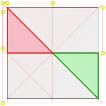

Consider a plain represented by the unit square. On this plain we want to “peacefully encamp” two armies of point-sized soldiers — one army red and one army green. Each soldier “attacks” chess-queen-wise: horizontally, vertically, and diagonally in all directions. The puzzle is to maximize the size of the equal armies (equivalently, maximize the size of the smallest army), given the constraint that no pair of opposing soldiers can be placed attacking each other.

Here are two examples of ways to peacefully encamp armies of sub-maximum size. The total size of each army in the first solution is 1/9; the total size of each army in the second solution is 1/8.
example1 example2

My best solution for two equal-sized armies gives each army an area of exactly $\frac{7}{48} \approx 0.1458$.
https://quuxplusone.github.io/blog/images/2019-01-21-1458.png 3
I am not aware of any proof that this is the best solution for two armies. However, you can approximate our point-sized soldiers with regular chess queens on an NxN board, and it turns out that many provably best solutions to that discrete problem for increasingly large N end up looking suspiciously similar to this arrangement of armies, and suspiciously dissimilar to anything else. For example.
