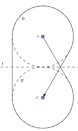

I would like to present this non-rigorous but hopefully more intuitive explanation for the optimal path. (The technique used here was very helpful for working on Oray's variant with two people.)
The first part of 2012rcampion's answer explains that we should go as far out as some tangent $l$, before going around the circle to get back to $l$ on the other side. Call the starting point $A$ and the circle $O$. Then the problem is this:
Find the shortest path that comes from $A$, touches $l$, then goes around the circle and touches $l$ again.
It won't change which path is shortest if we turn around at the end and go all the way back:
Find the shortest path that comes from $A$, touches $l$, then goes around the circle and touches $l$ again, and then goes back around the circle to $l$ and then $A$.
Now, if we reflect the entire diagram over $l$, we get this:
1]
Instead of having our path touch $l$ and go back, we can have it switch sides every time instead, which won't change the length because it's just a reflection. So now the problem is this:
Find the shortest path from point $A$ that goes around circle $O^\prime$, then around circle $O$, then goes to point $A^\prime$.
Anyone should be able to do that (imagine putting a string from $A$ around the circles to $A^\prime$ and pulling it tight):
2]
And now if we only look at the part of the diagram above $l$, there's the answer without any calculations.
