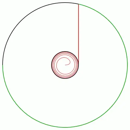

It is possible to escape a monster that is a little more than $4.6$ times faster. Given a monster running at speed $X$ times rowing speed and a lake with radius $R$, you must first row to the circle that is $R/X$ from the centre of the lake by spiralling out while keeping the centre of the lake between you and the monster. Thereafter you should take a route that is tangential to this circle in the opposite direction of what the monster is currently running. This is longer than going the direct route to shore, but the monster also get a longer route to run.
Your path in red, monster path in green. The shape of the inner spiral is not exact.
Why is this exact solution best? Because of differential maths. That is a long explanation, personally I find that stuffing some equations into Wolfram Alpha works.
It turns out that the monster must run $R(\pi+\varphi)$ where $\varphi$ is given by:
$\tan(\varphi)=\pi+\varphi,\\0\leq\varphi\leq\pi/2$
From the circle you have to row a distance of $R\times\sin(\varphi)$, so the fastest monster that can be overcome is running $(\pi+\varphi)/\sin(\varphi)$ times faster than you row, which is approximately equal to $4.6033388487517$

  • The monster can change direction if it is quicker to you in the opposite direction. In the last leg before you reach the shore, the monster will not necessarily continue in the same direction. – Neil Aug 27 '14 at 15:37
    @Neil If the monster change direction, so do you, you can mirror your path at any point if necessary. But according to the described monster behaviour the monster will not change direction during the last leg as there is no point where you are closer or as close the other way round. – aaaaaaaaaaaa Aug 27 '14 at 15:46
  • @EnvisionAndDevelop The inner circle is located exactly where you can only just keep up with the monster, therefore as soon as you are outside it there is no way to go so fast that the monster change direction. – aaaaaaaaaaaa Aug 27 '14 at 16:35
  • @EnvisionAndDevelop In which case you must of course move down. – aaaaaaaaaaaa Aug 27 '14 at 17:15
    Actually, the spiral in the circle can be replace by a semi-circle. You can reach the circle in finite time! – Florian F Sep 14 '14 at 15:15
