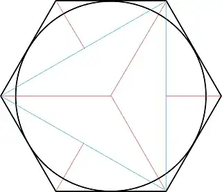

Opaque circle solution with a length of ~4.8264 km
Plough a $120°$ section of the circle, extending both ends in a straight line by a distance of $\sqrt{1/3}$ km to meet the vertices of a hexagon enclosing the circle. Two more lines of length $1$ km and $\sqrt{1/3}$ km are ploughed as shown to cover paths through the other half of the circle. The total length ploughed is equal to:
$$\frac{2\pi}{3} + 3 \times \sqrt{\frac13} + 1 = 4.82644591 \ \text{km}$$

  • You make us all look like amateurs lol. Thanks for the reference btw :) – Allan Apr 13 '15 at 22:39
    It annoys me that even though the puzzle is symmetric, the answer is not. – Etheryte Apr 14 '15 at 00:17
    What software do y'all use to draw these shapes? – JLee Apr 14 '15 at 00:36
  • Good answer. Why can't you place 6 (?) regions sized root 1/3 lengths and achieve the same result. It's interesting that the solutions seem to be asymmetrical. – Jiminion Apr 14 '15 at 13:25
    6 sqrt(1/3) lengths, pointed towards the center from each of the hexagon's vertices, would not be able to see a North-South tunnel in the center. – user3757614 Apr 14 '15 at 22:05
  • If such asymmetrical pattern is the optimal solution (as it appears to be), I don't want to believe in nature, science and universal harmony anymore! – leoll2 Apr 15 '15 at 15:31
    To the people who find it strange that the solution to a symmetrical problem is non-symmetrical: This is not unusual. Take magic squares for example, there are multiple 3x3 magic squares, each of which is non-symmetrical by itself. But the saving grace is that the SET of all solutions is symmetrical, i.e. for any magic square with 9 in top left, there will be corresponding ones with a 9 in the other 3 corners. The same is true here - any rotation/reflection of the above diagram is also valid. For any symmetrical problem, the set of all solutions is symmetrical, that's the rule. – astralfenix Dec 29 '16 at 14:37
