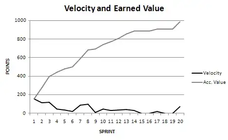

I have plotted my team burn up chart and its velocity per iteration. To me it looks really bad (velocity fluctuates a lot). What should I be looking for to diagnose the root cause of this behaviour?
BurnUpChard and VelocityPerSprint

  • How can a burn-up chart not track with velocity? Points are points...there's something wrong with your data. – Todd A. Jacobs Jan 30 '13 at 12:07

By itself, the fact that your velocity fluctuates doesn't matter. You can use a tool like Mike Cohn's Velocity Range Calculator, or a simple trailing average, in order to figure out what your normal velocity range is. Personally, I like to use 90-day trailing average, but the exact methodology is less important than the fact that you should treat velocity as an historical metric for predicting confidence intervals for future estimates.
What Your Velocity Tells You
There's not enough information provided for anyone to tell you why your velocity has so much variance, but it's trending mostly down, and there are a number of sprints that produced zero points. Therefore, one can draw a number of likely conclusions.
  • Your project has hidden complexity, or your estimates are wrong.
    If you're consistently missing Sprint Goals (not velocity targets; that's entirely different), you may be underestimating the work-effort for user stories, pulling too much work into each sprint, or are paying the price for technical debt that you took on earlier in the project.
  • You had early success, but have hit a wall.
    This may be the result of technical debt, changes to the project, or changes in your team composition. Alternatively, you may have changed your point system, and the easy points earned earlier in the project are no longer artificially boosting your graph lines.
  • You're measuring the wrong things.
    Your accrued value continued to rise between sprints 8-14, even though velocity was low. Either your accrued value is completely unrelated to the size or volume of delivered features (possible, but suspiciously unlikely), or you are delivering features that aren't assigned story points within your sprints.

Draw a line that represents the rolling average over that period, then draw lines that represent upper and lower control limits at 1, 2, and 3 sigma. Then analyze again. Your Y axis goes from zero to 1,000 which can make normal variation look extreme and volatile.
You must use control limits to determine if you have a special cause. Else, you have normal, random fluctuations.

What I would suggest before proceeding with a root cause analysis is to challenge your basic assumption that there is a problem. You say that to you the variability in sprint velocity looks bad, but does this variability have business impacts that warrant the time and effort to investigate the root cause, develop and implement corrective actions, and then monitor the effects of that corrective action on future projects?
