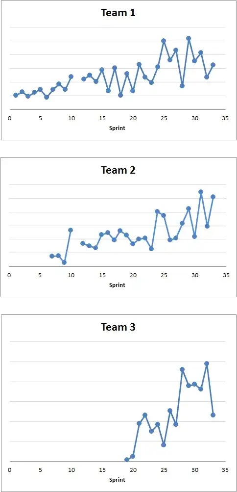

I am supporting and coaching several scrum teams working on different areas of the same software project. Sprints are 4 weeks long, except that sprints spanning the Christmas/New Year holidays are 5 weeks long. (The first six or so sprints were 3 weeks, before the teams decided to change them to 4.) All of the teams' velocities have a very noticeable pattern of zigzagging, where velocity alternates between higher and lower values every single sprint. In the graphs below, the Y axis is points Done per sprint; the gray lines are 10 story points. Each team has an independent backlog and estimates its own stories, so while points are not consistent between teams they are consistent within teams. In raw numbers one team completes twice the points of the other teams, so the graphs are normalized across teams under the assumption that each team's average velocity is equivalent, to prevent "point competition".
The teams explain this variation as having mostly Done stories carry over to the next sprint, so that some sprints finish fewer stories and other sprints finish more. Teams typically commit to a third or a half more points than they actually finish, and many of these extra points are "In Development" at the end of each sprint. Developers are resistant to smaller stories or shorter sprints as they "wouldn't have time to finish anything" and "would always be in Scrum meetings".
This is related to Team velocity fluctuates a lot, how to find the root cause?, but I think it is a much more specific issue. From those answers, I considered impediments and unbalanced work as possible explanations, but they aren't enough by themselves to cause this extreme zigzagging. Turnover on the teams is low and much of the velocity variation has occurred during periods of stability.
1) Have you seen such consistent zigzag patterns in velocity on your teams?
2) Does this pattern suggest a problem?
3) If so, what is the problem, how it is harmful, and how is it correctable?
velocity charts

  • Welcome to PMSE! How many story points are "not done" at the end of each of these sprints? And what's the scale on your Y-axis? – Todd A. Jacobs Jan 05 '15 at 23:36
  • What is the Y-axis of these graphs? How much variation are we talking about here? Is this +/- 2 or 3 story points or 20? – Thomas Owens Jan 06 '15 at 18:55
  • Each line is 10 points, so velocity regularly swings by 20 to 30 points between sprints. – Joel Jan 07 '15 at 18:05
  • The upward trend is more concerning than the zigzag. Typically that indicates everyone is padding their estimates more and more. Try comparing this with an actual # of items delivered chart as well. – Andrew Clear Jan 07 '15 at 20:14
  • If, at the end of a sprint, you have a 5 SP story with 1/2 SP of effort left on it, for how many SP does this story get planned in the next sprint? – Bart van Ingen Schenau Jan 12 '15 at 16:02
  • An incomplete 5 SP story is planned at 5 SP in the next sprint, regardless of how complete it is. (It would seem like this should cause spikes of Done stories at the start of every other sprint, but this is not observed. However, that may be explained by QA being a week+ bottleneck between code-complete and Done.) – Joel Jan 13 '15 at 04:08
The zig-zag is usually caused when a majority of stories are longer than the length of the sprint, so you end up with one sprint where little is completed, and one where lots of stories are finished and velocity is high. Plot yourself a histogram of stories against how long they take to complete (actually take, not the story points), and you'll probably find this is the case. This also makes compelling evidence to persuade people to fix it.
Even if the overall trend is upwards, at the moment you're getting feedback on a large number of items which have been in play for two sprints or possibly even longer. That becomes expensive to fix when the feedback tells you you got it wrong, since the knowledge involved in the work decays over time, and further work cements it in place. The whole point of Scrum and Agile methodologies is to be able to change course if something is wrong.
So, just because the velocity is healthy, doesn't mean that this isn't going to cause an issue. Check your bug count and whether that's rising, and find out how long it takes to fix those bugs.

There are specific rules in diagnosing a run or control chart. I quickly found this link that has a high-level explanation:
http://www.skymark.com/resources/tools/control_charts.asp
Everything produces variance, including an automated or robotic process. You need to determine whether the variance is "common cause", i.e., purely random, statistical noise; or "special cause," i.e., something is wrong with the process. The way a variance is produced will indicate with some degree of validity (meaning there are both type I and II errors in doing this type of analysis) whether or not the variance you are noticing is random or not.
Depending on the source, you'll see different "indicator" rules but some common ones are:
  1. six or seven consistent results above or below the mean
  2. constant up and down results exceeding 14 observations (Team 1 is exhibiting this between observation 8 to 22 or so.)
  3. four or five results above or below one sigma
  4. two or three results above or below two sigma (Depending on the y-axis and the calculation of sigma, team 3 might be showing something.)
  5. one result above or below three sigma (considered as upper and lower control limits.)
Type 1 and 2 errors are an issue and you need to understand how they occur. If your chart is too sensitive, you could get a ton of false positives and vice versa if too insensitive. So you need to consider your findings as probabilistic, not deterministic.
Yes this is a common observation, especially with teams that aren't accountable to a customer or 3rd party for delivery of an increment at iteration end.
It depends. If what they commit to delivering at the end of the iteration also goes to production or must be delivered to an external stakeholder this is definitely a problem. If your scrum teams have delivery timelines outside of the iteration it may not be a problem for the customer, but should still be investigated as large variances are an indicator of inefficiencies/ineffectiveness on the team.
There are many root causes of this problem. Some common ones are (and please determine if any of these may apply to your situation): stories poorly defined at iteration start, stories not appropriately sized or decomposed, Scope changes on stories after planning, non-visible work is frequently injected into the iteration, large cycle times on stories (this can have several root causes as well), no incentive to honor commitments at the iteration level.
Ultimately this is harmful if your customer frequently doesn't get the value they were promised at the end of the iteration. It can erode trust and confidence in using Agile-Scrum as a delivery framework since mature teams should be able to deliver the majority of their commitments fairly consistently at iteration end.
How to correct the problem depends on the root cause(s). Some corrections include: reducing the duration of the iteration, improving backlog quality and understanding during planning activities, allowing the team to under-commit and then back-filling extra work near iteration end until the team matures its estimation capabilities and commitment confidence, ensuring all real work is tracked, ensuring there is a real incentive at iteration end to meet commitments, introducing work in progress limits to focus the team on cycle times.
