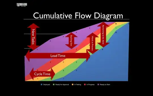

  3. Cumulative Flow Diagram
    Cumulative Flow Diagram can be very useful as long as you know how to read it. CFD shows how cycle/lead has improved over time, how big backlog has been over time, how often we release new versions etc.
    CFD doesn't show specific numbers, Excel sheet works way better here, but is way more useful to show trends, e.g. cycle time becomes shorter, we keep release frequency at stable rate and our backlog is at steady size since we're constantly getting new features to build.
    A longer description of how CFD works and what kind of interesting stuff we can learn from it can be found here.
    And here's a Paul Klipp's picture which describes what you can see on CFD: Paul Klipp's picture of Kanban CFD

  • Comprehensive answer Pavel, thanks. I do all pretty much all those things you recommend except we don't estimate task duration. I have been making a note of task entry and exit dates but yet to run analysis on them.
    The link to the image is very useful but I still find reading the CFD unintuitive.
    – Gary Feb 24 '11 at 13:17
  • I find Excel sheet more useful to find specific data, e.g. how long it typically takes to complete a feature, and CFD (which I don't use very often) to show trends, e.g. how do we improving cycle time over time. However it's hard to discuss CFD in general - it works much better when you're familiar with the example. – Pawel Brodzinski Feb 24 '11 at 13:45
