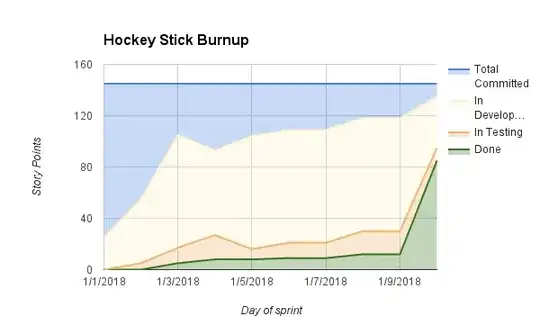

Useful charts for a Kanban system shows how to read a Kanban cumulative flow chart. I am wondering what patterns stand out on a Scrum cumulative flow burnup? I've seen two patterns frequently: the hockey stick and the bottleneck. What other problem behavior can show up in a flow burnup, and what can be done to correct it? Also, what intermediate states may be fruitfully charted other than In Development and In Testing?
Hockey Stick Burnup
This example uses mock data; see How can we avoid finishing all stories on the last day of a sprint? for a real-life example and some great discussion.

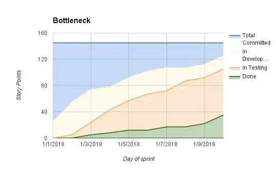

Scrum Cumulative Flow Burnup showing testing bottleneck
See Best strategies for dealing with integration testing bottlenecks? and How to better balance resources in a cross-functional agile team? for some discussion relative to bottlenecks.

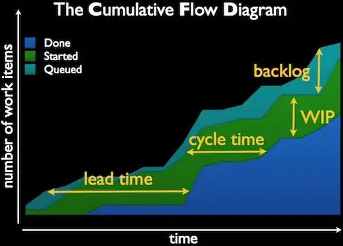

This graph may help you read your CFDs (source):
CFD
