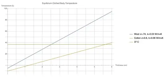

Starting from the temperature of the garment's exterior, this allows us to track back and find the corresponding body temperature as a function of thickness. I've performed the calculation for wool and for cotton, with the results shown below.
Clothed Body Temp
The surface of a wool sweater would equilibriate at approximately -5 C, which would correspond to a 37 C body temperature if the thickness of the sweater were only about 3 cm. That's thick, certainly, but not absurdly so. For a cotton sweater, which would have both higher emissivity and higher thermal conductivity, the surface would equilibriate around -10 C and you would need a thickness of closer to 6 cm to keep you warm.
