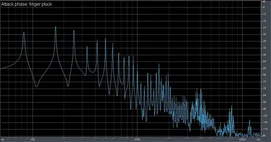

As an addition to the other answers, here's the frequency spectrum of an open low E string of an electric guitar (a Squier strat with a bridge humbucker), strummed with the fleshy part of the finger, plucked with a fingernail, and picked with a plectrum (a Dunlop Delrin-500 .71mm). I played each note a couple of times and then selected one that sounded representative, and was of somewhat equal volume.
For the attack phase I used the first 250 ms of the note, for the sustain phase I used the part from 1 to 1.5 seconds. The graph shows the level in dB of frequencies from 50 Hz to 15 kHz on a logarithmic scale.
frequency spectrum of strummed guitar
I don't make any claims as to how scientific this is, but it's better than looking at the black body radiation of an incandescent light bulb :-)
I think it's fair to say that there is a clear difference in the spectrum of the plectrum-picked note; the harmonics up to around 10 are of comparable amplitude, whereas in the finger-plucked note the first three harmonics clearly dominate the sound. The frequencies between 1 and 2 kHz are also more prominent, and the troughs around 2.5, 6 and 10 kHz are narrower and they all but disappear in the attack phase.

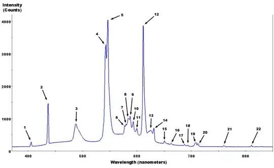

and the smooth spectrum of black body radiation you get from an incandescent bulb. enter image description here
