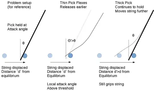

Thicker picks (tend to) remain in contact with the string longer. The impulse provided to the string is of longer duration. A longer duration pulse imparts more lower frequency and less higher frequency content.
Imagine the thick pick, at an angle, coming in to hit the string. It strikes the string, which starts to move along with the pick, but the pick itself is not deformed much initially. Driven by the hand, the pick continues to press the string downward. Eventually the downward motion of the pick, along with changes in its attack angle (even if the pick itself is very stiff, there is some play just in terms of your finger tips) get to the point where the string is "released" from the pick and starts to vibrate freely. This release occurs because while you are pushing the string further down, the string is pushing back more and more; eventually the tension in the string, along with the changes in the attack angle of the pick, get to the point where the string starts to slip and is released. The amount of time from the initial impact of the pick on the string to the time that the string is released bound/defines the time span of the impulse that is provided to the string.
The interaction of a thinner pick is the same, except that the pick itself now flexes; this means that the string will release from the pick sooner: the pick is flexing more and less able to resist the back pressure of the string.
Though this glosses over some of the details string-pick interactions, we can look at when the string will start to slip in terms of the following diagram Pick string interaction
Assume is already in contact with the string and displaced it a distance d from its resting position. Also assume that the pick, at the point of contact with the string is at an angle $\theta$ from the normal to the plane spanned by the vectors along the length of the string and along the picks direction of motion. In order for this point of the string to continue moving with the pick (I'm assuming that the picks speed is kept constant by the guitarist) the net forces need to be zero (no acceleration). Three forces are in play: the restoring force due to the tension in the string, the normal force, and the static friction between the pick and string. We only need to consider the vertical components of the force in the diagram above, which yields the equation: $\mu N \sin \theta - N \cos \theta =0; solving for the static coefficient of friction yields $\mu=\tan \theta$. Given that there is a maximum value for the static coefficient of friction (determined by the material composition and surface structure of the pick and string) above which the string will start to slip along the pick, there is also a critical angle of attack. Getting back to picks, for a thick (stiff) pick, the attack angle only changes from flection in the finger tips; for a thin (flexible) pick, the pick itself flexes, increasing the attack angle. Thus the thin (flexible) pick releases sooner (everything else held fixed) because it "bends to get out of the way", as in the following, exaggerated for effect, picture.
pick deflection

The state of the string when it releases from the pick sets the initial conditions for the string's vibration. The model I have in mind involves
  1. The string is at rest, and straight.
  2. The pick is moving downward at some rate dictated by the hand.
  3. The pick first strikes the string.
  4. Due to friction, the string moves along with the pick (and the hand) at that rate. I've idealized the area of contact to be a point.
  5. That point on the string continues to move downward at the same rate as the pick until a the static friction threshold is reached, and the string is released.
  6. After this point the string freely vibrates.
At this time, the pick has pushed down at one point in the string. The "height" of the displacement is (hand-speed)*(grip time) -- while the pick "grips" the string, it is moving with it (and with your hand). The deformation caused by the pick spreads out from the pick at the wave speed in the string. The half-width of the tent along the string is (wave-speed-in-string)*(grip-time). Thus the width of the pulse in the string, and thus its spectral content is affected by the amount of grip time. Points on the string further away cannot yet be affected since disturbances travel through the string at the string's wave speed.
