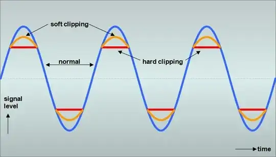

Distortion
One of more commonly known effects for musicians is distortion. It falls into the family of effects sometimes referred to as "dirt" boxes: Distortion, Overdrive, and Fuzz. In simple terms, it is cutting the top and bottom of the sound wave off using a technique known as "hard" clipping to create a more square shaped wave instead of the more natural sine wave formation. A solid explanation on the techniques and methods of creating different types of distortion can be found on Wikipedia.
B0nk3r
  • 329
MaQleod
  • 249
    No offense, but I may edit this to remove the wiki reference and expand on what Distortion (more commonly referred to as overdrive) is. I sometimes feel dirty whenever I see a wiki link :D. – Jduv May 03 '11 at 14:05
  • @Jduv - I can't imagine that he would take offense. Please update the answer - that's why this is CW, and is entirely in the spirit with which I asked the question! – gomad May 03 '11 at 18:18
  • I like the wiki link, leave it in as Wiki is another collaborative source just like this site. – JPM Oct 27 '11 at 17:18
  • Actually this can be merged with fuzz answer – teodozjan Jul 11 '12 at 14:56
  • Agree - I was trying to work out what the difference between fuzz and distortion/overdrive is. They're both abouta wave getting squared owing to some degree of saturation. If there is a difference, maybe it's worth making that clearer ? I'd do this myself but i@m only familiar with the term distortion/overdrive. – user2808054 Jul 15 '14 at 08:52

Overdrive
The overdrive pedal is similar to a boost pedal; where the pedal will increase the amplitude of the input signal, therefore having a very large output signal that will be large enough to be distorted by the amplifier.
However, unlike a boost pedal, the overdrive effect is not dependent on the amplifier to have a distorted sound. The overdrive pedal will internally boost the input signal so much that the top of the signal wave will be forced to naturally shrink itself. This is called soft clipping and it simulates amplifier like clipping as though an amplifier was being overly driven, hence the name overdrive. The distortion pedal will also boost the input signal but will then add resistors within the circuitry to not just shrink or soft clip the wave form but completely flatten the wave peaks. This is called hard clipping. For more understanding on the differences between soft clipping and hard clipping see the illustration below.
Overdrive vs Distortion wave form comparison
Multi-Processing Overdrive (most common)
The most common overdrive will also alter the tone of the input signal by adding in a muli-processing chip within the circuitry. Such as the classic Ibanez TS-808, made in the 1980's, having the MP-D01201A multi-processing chip. Depending on the brand of the overdrive, the installed multi-processing chip and the preferences of the player, this type of overdrive is typically a go-to overdrive and is commonly the cheapest to purchase.
Examples of multi-processed overdrives:Ibanez TS-9, Ibanez TS-, Electro-Harmonix East River Drive.
