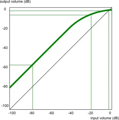

My explanation is more for generic compressors, but I believe it is relevant for guitars as well.
A compressor is most often used to amplify quiet sounds more than loud sounds. You could think of it as someone turning up the volume on quiet parts, and down on loud parts. This is done by a compressor much faster than a human with a volume knob could :)
As a result, the output has a thinner volume range than the input of the compressor.
Here is an example of a compressor setting:
Example of compressor setting
If there is no compression at all, the output is equal to the input. If you have -20 dB in, you'll have the same -20 dB out. It is represented by the black line in the graph.
With compression as in the example above (green curve):
  • if you have -80 dB in, the output will be right above -60 dB (20 dB amplification).
  • if the input is at -20 dB, the output will be at -8 dB (12 dB amplification).
  • if the input is at -3 dB, the output will also be around -3 dB (no amplification).
In other words, the amplification gain varies with the loudness of the input.
Further, this gain is often restricted from changing too fast. This is what attack and release times are for. The attack time prevents the gain from going up to fast, while the release time prevents it from going down too fast.
