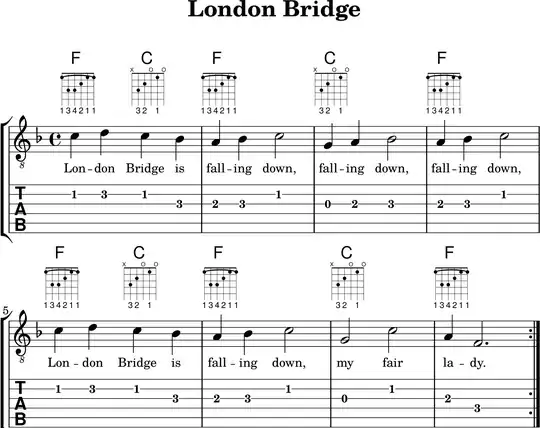

The free software Lilypond comes with a tool called midi2ly, it converts midi-files to lilypond-files and lilypond outputs pdf-files by default. But as many of the other answers already stated: "The real work starts when the conversion is done!"
I think many of the aspects are covered in the other answers but I'll show a quick example how a score can look like directly after a midi import:
$ midi2ly infile.midi -o outfile.ly
$ lilypond outfile.ly
And here is a the finished score, witch apart from:
  • typing the notes
  • setting key and time signature
needed to be completely remade.
