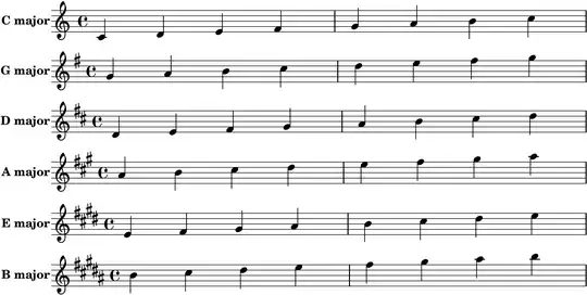

I would dare to say that every serious notation software is capable of transposing a score to a different key or a different octave. The problem would be rather how to get a PDF-file into that software.
Here is a very basic example using LilyPond for transposing a simple scale to different keys:
\version "2.18.2"
\paper {
  ragged-last = ##f
music = \relative c' {
  \key c \major
  c d e f g a b c
% C major =========================================
\score {
  \new Staff \with {
    instrumentName = \markup { \bold "C major" }}
  \transpose c c {
    \music
% G major =========================================
\score {
  \new Staff \with {
    instrumentName = \markup { \bold "G major" }}
  \transpose c g {
    \music
% D major =========================================
\score {
  \new Staff \with {
    instrumentName = \markup { \bold "D major" }}
  \transpose c d {
    \music
% A major =========================================
\score {
  \new Staff \with {
    instrumentName = \markup { \bold "A major" }}
  \transpose c a {
    \music
% E major =========================================
\score {
  \new Staff \with {
    instrumentName = \markup { \bold "E major" }}
  \transpose c e {
    \music
% B major =========================================
\score {
  \new Staff \with {
    instrumentName = \markup { \bold "B major" }}
  \transpose c b {
    \music
a short description of how to convert MIDI to LilyPond input-files can be found here.
