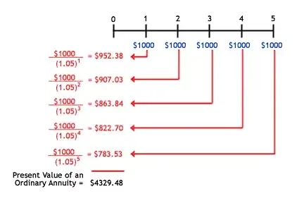

Using the model for an ordinary annuity from here: Calculating The Present And Future Value Of Annuities
E.g.
The summation for your fund would be
giving the present value required as $513,866.47

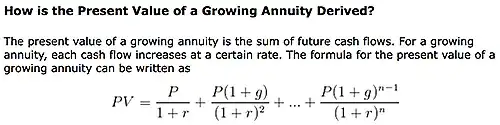

THEAO
  • 3,391
