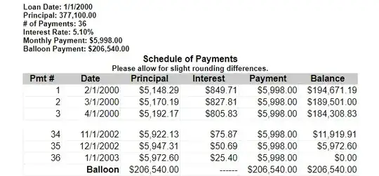

from this web site https://www.mortgagecalculator.org/calcs/balloon.php, it shows the effective interest rate is 11.02% (amount borrowed: 377100, long term in years: 3, Upfront payment: 41900, loan fees: 0, balloon payment at end: 206540, monthly payment: 5988.99) How come the interest rate is much high that we calculated? Please help.
Editing the OP's post
With r = 0.00425237 per month, as calculated in the addendum.
Nominal annual interest rate, compounded monthly 12 r = 5.102844 %
The results below are based on 36 payments of 5998 plus a final payment of 206540 at the end of month 36. The total paid in month 36 is 212538.
Top and bottom of amortisation table. Note the principal amount: 377100.

  • Thx Chris, but for "Amount Borrowed", should be 419000 or 377100? Since the house is 419000, and I need to pay 10% down payment, so the Amount borrowed, should be 377100, right? – north 27 secs ago – north Mar 26 '19 at 10:02
  • For the website calculator Amount Borrowed should be 419000 and Upfront Payment should be 41900. The calculator automatically deducts the upfront payment from the amount borrowed to obtain the Principal: 377100, as shown in the Amortization Schedule. Try setting the website calculator up as I have shown and check the amortization schedule. – Chris Degnen Mar 26 '19 at 10:25
  • Thx Chris! Much appreciate for your help! Now, is much clear. Thanks a lot! – north Mar 26 '19 at 15:15
