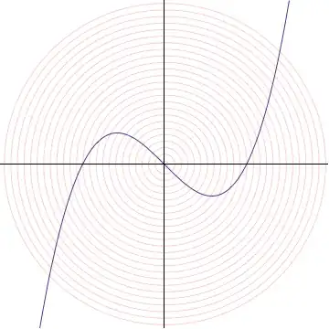

An animation of your first example, $y=x(x−1)(x+1)$. I limited the number of frames so that the file would not be too huge (it is ~1MB now). Frame rate is browser and processor dependent. At best this gives an idea of what a more professional animation might look like.
           Zoom
