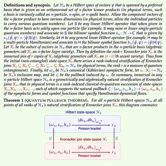

Note added: At the 52nd ENC Conference at Asilomar conference, we reduced the above ideas to practice, by redrafting Chapter III of Slichter's Principles of magnetic resonance in the language of geometric dynamics (PDF here, Wayback Machine). Here is the main theorem:
6 (source: Wayback Machine)
In essence, it turns out to be surprisingly easy to construct nonlinear quantum state-spaces that respect both thermodynamic "goodness" (that is, Kählerian structure) and quantum "goodness" (that is, Lindbladian structure).
Ought we to regard Kronecker state-spaces as legitimate quantum foil theories? Or are they merely useful computational idioms? Don't ask us ... as quantum simulations become more-and-more realistic, the division between quantum foil theories and practical computational tools is becoming less distinct.
