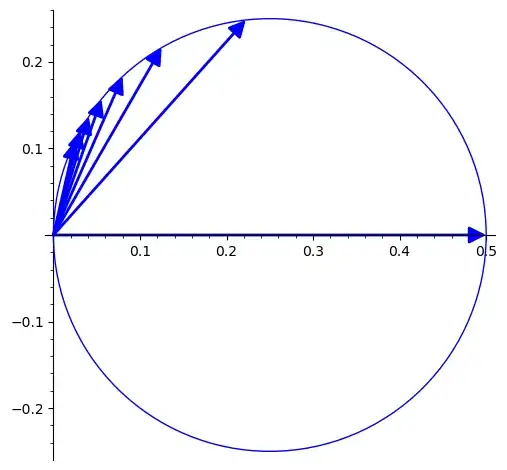

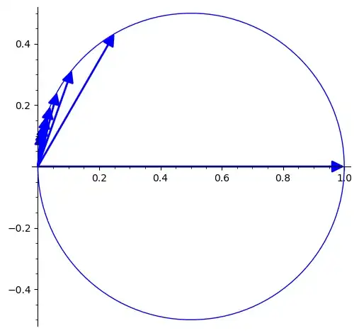

The Lyman series and similarily the other following series might be visualized as:
visualization_lyman_series
visualization_balmer_series
In this visualization we use the fact that:
$$d(a,b)^2 + \frac{1}{a^2} = \frac{1}{b^2},\text{ if } b < a$$
which can be immediately recognized as Pythagoras theorem, since $|\phi(a)| = \frac{1}{a}$. One can also recognize the circle of Thales in this context of visualization. The angle $\rho$ between $n=a$ and $n=b$ used in this visualizations, is given by:
$$\cos(\rho) = \frac{k(a,b)}{\sqrt{k(a,a)k(b,b)}} = \frac{\frac{1}{\max(a,b)^2}}{\sqrt{\frac{1}{a^2b^2}}} = \frac{ab}{\max(a,b)^2} = \frac{\min(a,b)}{\max(a,b)}=\text{ one Jaccard kernel / similarity}$$
One can add, that doing kernel PCA with the given kernel $k(a,b)$ above, in two dimension, yields a similar, if not to say identical image as used in the visualizations above.
