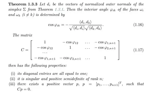

I have found an answer:
The right generalisation of this question from triangles to simplices is the question of dihedral angles:
In the book "Matrices and Graphs in Geometry" by Miroslav Fiedler, we have the following generalisation of the sum of angles equals $\pi$ in triangles:
dihedral angles in simplices
Here is some Sagemath-Code which implements this idea.
For example for $3$ points we have the following algebraic variety given by $\det = 0$ :
$$0 = 2 \, c_{12} c_{13} c_{23} - c_{12}^{2} - c_{13}^{2} - c_{23}^{2} + 1$$
which is the Cayley nodal cubic.
