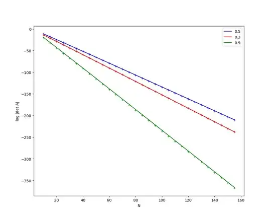

Edit: I attached the following figure showing the result of Carlo Beenakker (lines)
$\mathbb{E} [|\det A|] \sim N p^{N+1}(1-p)^{N-1}+p^{N}(1-p)^N $
and results from simulations (crosses) for different $p$. They seem to fit very well.

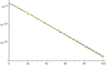

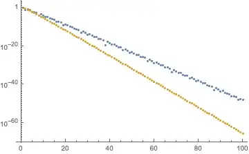

For $p\lesssim 1/2$ the Hermite polynomial formula (blue, absolute value of esg 's answer$^*$) is not far from ${\rm det}\,\bar{A}$ (gold, above formula), see the plot for $p=0.4$ (at left) and for $p=0.05$ (at right):

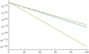

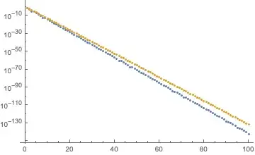

For $p>1/2$ the Hermite polynomial formula decays less rapidly, but still exponentially: plots for $p=0.7$ (at left) and for $p=0.95$ (at right). The difference from the exponent $\alpha$ given above is close to a factor 1/2 for $p$ approaching 1 (compare with green curve $\propto (1-p)^{N/2}$).
In summary, based on this comparison I would conclude that the exponential decay of $\mathbb{E}\,({\rm det}\,A)$ crosses over from $\propto p^N$ for $p$ near 0 to $\propto(1-p)^{N/2}$ for $p$ near 1.

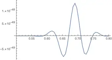

$^*$ I plotted the absolute value of the Hermite formula. It oscillates around zero with increasing $p$, here is for example a plot for $N=100$.

    I compared the results for the average matrix without fluctuations with numerical results for the average absolute value of the determinant of A and they seem to fit very well. I will provide plots in a few days. – Hipstpaka Dec 24 '18 at 14:44
