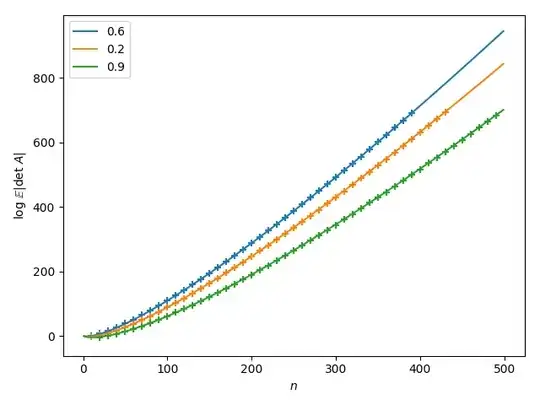

It feels like this has been done already, but after searching for quite a while I performed simulations and it looks like
$$\mathbb E(|\det(A)|) \propto e^{n f(p) }$$
where $f$ is some function of the probability $p$.
Comparison of simulation results and solutions described below for different values of <span class=$p$." />
I would be very happy if someone knows the result or a good reference where I could look it up.
Edit: I changed the figure and added plots of the solutions
$$ \text{log} \mathbb E(|\det(A)|) \propto \frac{n}{2} \text{log} \frac{n p (1-p)}{e}$$ given by Richard Stanley and RaphaelB4 which coincide up to multiplicative terms if the factorial in Richard Stanleys solution is replaced by stirlings formula.

  • Math experiment done with Maple produces $E(\det A)=0$ for $n=1,…,4$ and $$p,-2,{p}^{4}+2,{p}^{2},12,{p}^{9}-36,{p}^{8}+36,{p}^{7}-18,{p}^ {5}+6,{p}^{3},-528,{p}^{16}+3456,{p}^{15}-10080,{p}^{14}+17280,{p }^{13}-19152,{p}^{12}+13824,{p}^{11}-5760,{p}^{10}+576,{p}^{9}+504 ,{p}^{8}-144,{p}^{6}+24,{p}^{4} $$ for $E(|\det A|)$. In view of it your hypothesis does not seem to be true. – user64494 Apr 06 '18 at 10:57
  • Thanks for your response. In the simulations I performed, the scaling relationship $E(|det A|) \propto e^{Nf(p)}$ is only valid for large $n$. Therefore, it could be that for small $n$ the expectation value behaves differently and maybe even decrease with increasing $n$. – Hipstpaka Apr 06 '18 at 11:44
  • I added a figure showing simulation results for $p=0.5$. – Hipstpaka Apr 06 '18 at 11:59

    It can be shown that the expected value of $\mathrm{det}(A)^2$ is exactly $n!p^n(p-1)^{n-1}(1+(n-1)p)$. – Richard Stanley Apr 07 '18 at 20:48
  • @Richard Stanley: This solution seems to be correct (see plot), thanks! Can you provide a source where to find a proof for this? – Hipstpaka Apr 08 '18 at 07:05

  • @RaphaelB4: This solution seems to be correct (see plot) and coincides with the one stated by Richard Stanley. – Hipstpaka Apr 08 '18 at 07:09
