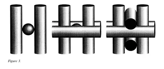

What is the maximum number $k$ of unit radius, infinitely long cylinders with mutually disjoint interiors that can touch a unit ball?
By a cylinder I mean a set congruent to the Cartesian product of a line and a circular disk. The illustrations, copied from 2, show various configurations of six cylinders, perhaps all possible - up to isometry. The question is about 25 years old; the answer is conjectured to be 6, but the conjecture is still unconfirmed. Heppes and Szabó 1 proved in 1991 that $k\le 8$; nine years later Brass and Wenk 2 improved this result to $k\le 7$. Also, one would like to know:
What does the configuration space of six unit cylinders touching a unit ball look like?
In particular:
Is the configuration space connected?
Even more specifically, referring to the configurations shown below:
Within the configuration space, is a continuous transition possible from the configuration in Figures 1 and 2 to the configuration in Figure 3?
The last question may be possible to verify by a natural candidate, but the necessary computations seem too tedious to me...

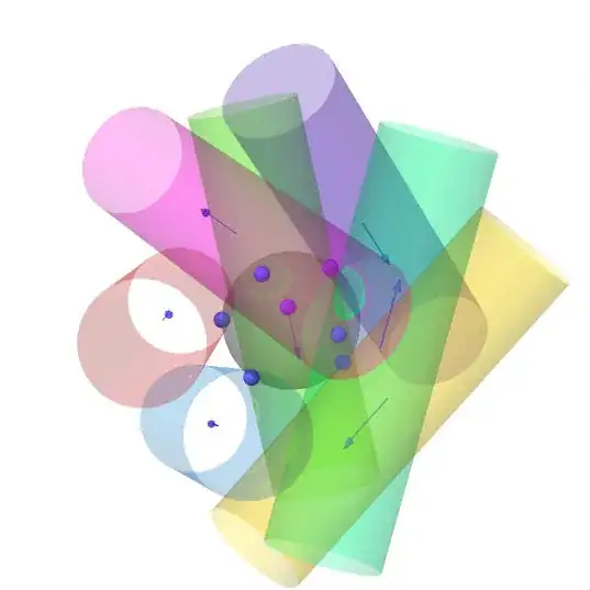

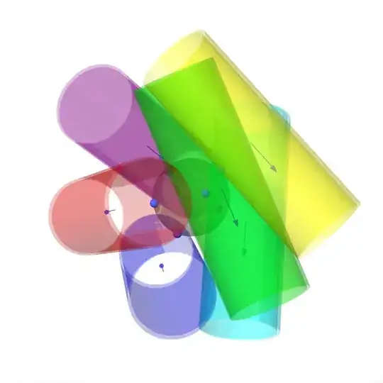

I wrote a little program that tries to find points in the described semi-algebraic sets. Here's what it found for $\mathcal{C}_6$ (click here for an animation). 6 kissing cylinders
Let's take a slightly different point of view. Fix the radius of the ball to be $1$, but let the radii of the $k$ cylinders vary while making sure all cylinders have the same radius. We can then ask: What is the largest radius $r_k$, so that we can find $k$ non-overlapping cylinders of radius $r_k$, that touch the unit ball? Hence the question is: $r_7\geq 1?$
An obvious lower bound on $r_k$ comes from the packing that allows a equatorial section which is a circle packing, as for $k=6$ in figure 1 and figure 2 in the question post. We therefore have: $$r_k\geq \frac{\operatorname{sin}(\frac{\pi}{k})}{1-\operatorname{sin}(\frac{\pi}{k})}$$ Here's a list of decimal approximations for small $k$s: $$\begin{array}{c|cccccc}k&3&4&5&6&7&8\\\hline \frac{\operatorname{sin}(\frac{\pi}{k})}{1-\operatorname{sin}(\frac{\pi}{k})} &6.464101& 2.414213& 1.425919& 1& 0.766421& 0.619914\end{array}$$ A perhaps surprising result of my calculations is the fact that $r_6>1$, indeed $$r_6> 1.04965$$ So in other words there is configuration of $6$ cylinders where the cylinders have radius larger than $1.04965$. Here is a picture of the configuration (again click here for an animation): 6 kissing cylinders
I also drew cylinders of radius $1$ with the same tangent points, so one can see the difference.
The configuration space can be viewed as subset of the the $6$th power of the unit tangent bundle of the sphere $(T^1(S^2))^6$ (see conditions 1.-4. and Henrik Rüping's comment).
The upshot of finding a configuration with larger radius is: the configuration space contains an open subset of $(T^1(S^2))^6$ and hence is $18$-dimensional locally.

Here is list of lower bounds on $r_k$ for small $k$:
  • For $k=3$ and $k=4$ I conjecture the trivial bound for $r_k$ given above to be sharp.
  • For $k=5$ one can find a configuration that shows: $r_5>1.45289>1.425919$
  • For $k=6$ we have $r_6>1.04965 >1$ as mentioned above.

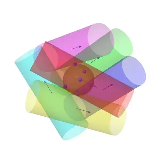

  • For $k=7$ I found a configuration that shows $r_7>0.846934>0.766421$. Here is a picture of this configuration (again click here for an animation):
7 kissing cylinders
