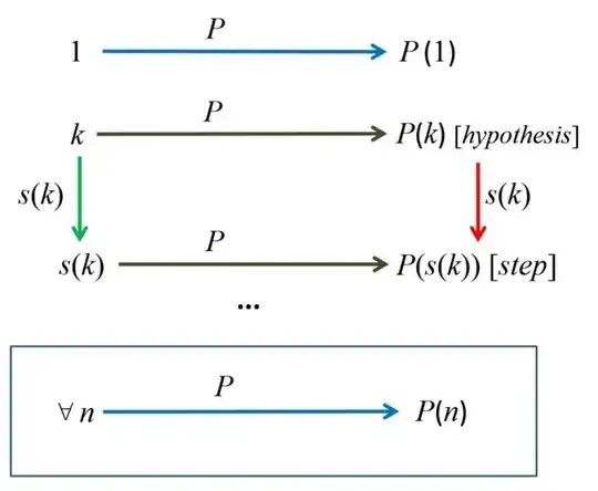

The staircase metaphor (I prefer a rope ladder) is useful when associated with the concept of enumerable sets, the prototype of which is $\mathbb{N}$.
I usually couple my explanation with a (very simplified) reference to Peano's axiomatization of natural numbers, to shake off the conventional understanding, and to create room for the idea that we are dealing with enumerations, regardless of how exactly they are represented. I would be nice if it is possible to suggest (provocatively) that not all sets can be enumerated, even if we allow the process to be infinite.
Only then I´ll introduce the rope ladder, without ever losing completely the connection to the symbolic level of description:
Remind the students that we have the "left rope" (the basic enumeration). What we need is to "attach the right rope to the left, one rung at a time".
It is important to emphasize that we are doing is to prove a property $P$ over a set of objects that are enumerable. We are not performing a calculation, but a demonstration (a "logic thing", not a "regular math thing").
All along, it is crucial to avoid isolating symbolic reasoning and explicative metaphor. If these are kept together, you can simplify and reiterate at will, without having to count on the students to "just get it".
  • If I am understanding it right, your analogy is not about climbing a rope ladder, but actually constructing a rope ladder. You have a rope on the left knotted at 1, 2, 3, 4, ... and a rope on the right knotted at P(1), P(2),... If the knot k on the left is joined to the knot P(k) on the right, then you are allowed to join the rung from k+1 to P(k+1) too. Is that right? – DavidButlerUofA Jun 02 '15 at 20:13
  • Yes, constructing. The induction step is the red arrow: if you can always get the next knot on the right side (if you get from $P(k)$ to $P(s(k))$), then you will always be able to fix the next rung (the "step" rung). – André Souza Lemos Jun 02 '15 at 20:22

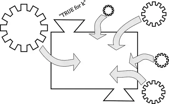

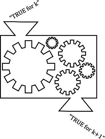

One analogy I have is for the induction step itself. I say that the induction step is like a machine that transfers the truth of the proposition from one number to the next. The machine takes as input the fact that the proposition is true for $k$ and spits out as output the fact that the proposition is true for $k+1$.
induction step machine
You proving the induction step is like constructing this machine. You technically haven't actually shown that anything is true, you've just made the machine that will show that something is true if you put a true statement into it.
The idea of induction is to start with a statement that you know is true, and then imagine continually feeding the output back into the input funnel.
I only thought of this idea recently, but so far it has had some success with students. It seems to help them understand the part that the induction step plays in the whole proof, and the fact that it works on statements rather than on numbers.
Another picture that helps is to draw the line of numbers as open circles, and colouring them in when you know they're true. The machine can be thought of as transferring the colour from one circle to the next. This GeoGebra activity illustrates the idea.
