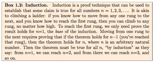

This is a version of user @Mann's comment. I owe the ladder metaphor to Joe Malkevitch:
  InductionBox
  (From How To Fold It: The Mathematics of Linkages, Origami, and Polyhedra, p.6.)
Joseph O'Rourke
  • 29,827
  • 61
  • 140
