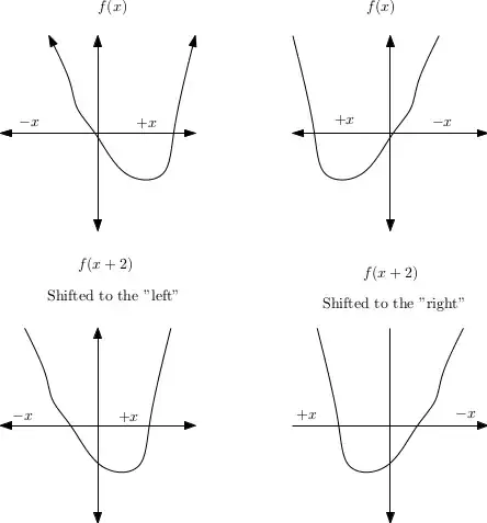

    This is a philosophical question. If we understood "up" to be plus and "left" to the plus, then there would be no confusion, yes? – Jared Oct 23 '14 at 08:22
    @Jared if "left" was plus, then putting in f(x+2) would move the graph to the right (toward x=-2)! – Chris Cunningham Oct 24 '14 at 14:18

This is a complicated question. It's complicated because we do not define our axes very well, yet we assume the following: $+x$ goes to the right and $+y$ goes up, therefore $-x$ goes to the left and $-y$ goes down. There is absolutely no rational for this other than convention (and then you can argue about how people think--although I might argue that left-handed people are wired to think "to the left" is "positive").
If you want to talk about directions in a graph, then you better define your axes very well (and no teacher that I've ever met ever does--mainly because it will likely confuse students--but a good teacher should confuse their students, i.e. make them think).
With that in mind, we can come up with two different scenarios where $f(x+\Delta x)$ shifts either to the right or to the left! Likewise we can come up with axes which show that $f(x) + \Delta f$ shifts either up or down!
1 Assume "to the right" is positive
Then how do we shift $f(x + \Delta x)$? We initially get the graph $f(x)$, what value of $x$ gives $x + \Delta x = 0$ (the original $f(x)$)? We can solve: $x + \Delta x = 0 \rightarrow x = -\Delta x$. This suggests that we should move the $x = 0$ point of $f(x)$ to the $x = -\Delta x$ point, which is to the left, since positive is to the right, negative must mean to the left!
2 Assume "to the left" is positive
Then how do we shift $f(x + \Delta x)$? We initially get the graph $f(x)$, what value of $x$ gives $x + \Delta x = 0$ (the original $f(x)$)? We can solve: $x + \Delta x = 0 \rightarrow x = -\Delta x$. This suggests that we should move the $x = 0$ point of $f(x)$ to the $x = -\Delta x$ point, which is to the right, since positive is to the left, negative must mean to the right!
Note that I copy and pasted my response to both of the above--that's because "to the right" or "to the left" are arbitrary choices that can be switched by a simple exchange of variables.
Here is an illustration:

    I think this really does confuse things more than help. The issue that axes direction is a convention is not what is confusing students here: it is the very real difference between pre-composition and post-composition. – Steven Gubkin Oct 23 '14 at 12:31
  • @StevenGubkin I really don't disagree that it's confusing (and I would probably not suggest trying to teach it this way), however, the OP seemed to suggest that shifting to the left when you add (i.e. $f(x+2)$) seems counterintuitive. I was simply trying to explain why it appears counterintuitive when in fact it's the convention of the axes and our preconcieved notions that makes it appear counterintuitive--it's not counterintuitive by nature. I do think the proper way to teach this is not to say it's "opposite", but rather have them reason through it. – Jared Oct 24 '14 at 05:46
  • I think this answer does not address the spirit of the question. The question could be rephrased "Why is the graph of $y=f(x+2)$ shifted in the negative $x$ direction relative to the graph of $y=f(x)$, which seems 'backwards' ?". You address that the negative $x$ direction could be left or right (or really any direction!), but that is just further confusing the issue by questioning a convention: it does not address the actual mathematical fact that you have to plug in values $2$ less into the new function to get the same value you got before, which is the whole issue at hand. – Steven Gubkin Oct 24 '14 at 14:11
    So the source of this being counterintuitive is not the convention of axes at all. Somehow $x+2$ results in moving $2$ negative units, which is against most student intuition. – Steven Gubkin Oct 24 '14 at 14:14
  • @StevenGubkin Actually I do address that problem: "Then how do we shift $f(x+\Delta x)$? We initially get the graph $f(x)$, what value of $x$ gives $x+\Delta x=0$ (the original $f(x)$)? We can solve: $x+\Delta x=0\rightarrow x=−\Delta x$. This suggests that we should move the $x=0$ point of $f(x)$ to the $x=−\Delta x$ point, which is to the left, since positive is to the right, negative must mean to the left!" Perhaps it would be better to use $x'$ instead of focusing in on $x = 0$ (which is not explicit in my explanation). – Jared Oct 26 '14 at 04:10
