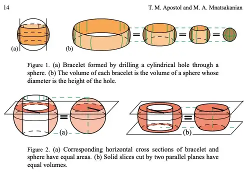

Pardon me ignoring your Calculus question, but there is some beautiful mathematics here, e.g., Cavalieri’s principle. So there is an opportunity to connect the calculus to these "fascinating results" (to quote Xander Henderson).
Bracelet
Tom M. Apostol and Mamikon A. Mnatsakan. "Volumes of Solids Swept Tangentially Around Cylinder." Forum Geometricorum. Volume 15 (2015) 13–44. PDF download.
