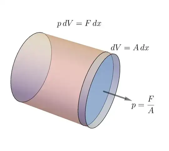

What is the $p\,dV$ integral?
I'm guessing that $p$ is pressure and $V$ is volume, and the integral has to do with the work done by the expansion of a volume of an ideal(?) gas.
A little bit of work, like a bit of area, is equal to the force $F$ (applied in the direction of motion) times a bit of displacement $dx$. Like the length of the screed, that force may vary. The total or net work is the sum of the bits of work: $$ W = \int F \; dx \,.$$
Now in a volume of gas, the force on the surface is equal to the pressure $p$ times the surface area $A$. To take a cylindrical volume an example, suppose only one end can move as below. It does not really matter the shape of the cross section, only what its area is. If the end has area $A$, then the force on it will be $F = p\,A$. If the end moves a little bit $dx$, then the volume changes by $dV = A\, dx$. Thus the bit of work done is $$dW = F\; dx = p \, A \; dx = p \; dV \,.$$
As the volume changes from one value to another, the accumulation of the bits of work is given by the integral: $$W = \int dW = \int p \; dV \,.$$ One may put numbers/letters on the integral sign, $\int_a^b$, to denote the beginning and end of the change in volume. In this example we can go one step further. First, $p$ is constant. Second, the sum of a constant times any number of bits can be computed by summing the bits and then multiplying by the constant. This is represented by $$W = \int p \; dV = p \int dV = p \, \Delta V \,,$$ where $\int dV = \Delta V$ is the net change in volume.
Now there's a remarkable thing. The example seems very simplistic: The face that moves is flat. It doesn't change area. And the pressure is constant. What about an expanding sphere or other shape? Most of what was said carries over without much change. The main difference, conceptually, is that we have to deal with the curved surface. To connect the curved surface with the cylinder example, break the surface up into little bits. Each bit is virtually flat and can be thought of as the end of cylinder that expands as above.
[Students would be right to doubt this, and it can be justified. Tell them that three semesters of calculus should clear it up in a jiffy. OTOH, it is the same idea as dividing a graph up into little bits of height times $dx$.]
In any case, the pressure leads to a force normal to the surface and parallel to the direction of expansion, just as in the cylinder. The bit of work done on each bit of the surface is $dW = p\,dV$, where $dV$ is the change in volume swept out by the bit of surface expanding. If we sum over all the bits of surface and all the bits of expansion, we get $p$ times the net change in volume, assuming $p$ remains constant.
[To break it down closer to multivariable terms, which may be unnecessary: Let $dS$ denote the area of each bit of surface, which plays the role that $A$ played above. The expansion $dx$ is normal to this surface. So the surface sweeps out a bit of volume equal to $dV = dS\,dx$. The force exerted in the direction of expansion is $F=p\,dS$. The bit of work done is then $dW = F\,dx = p\,dS\,dx = p\,dV$. Then the sum over the bits of surface $dS$ and over the bits of displacement $dx$ may be represented as a nested surface and scalar integral: $\int\mkern-6mu\int\left(\int p \, dx\right)dS$. That may go too far, but they used surface integrals in my physics class before we barely knew what an integral was.]

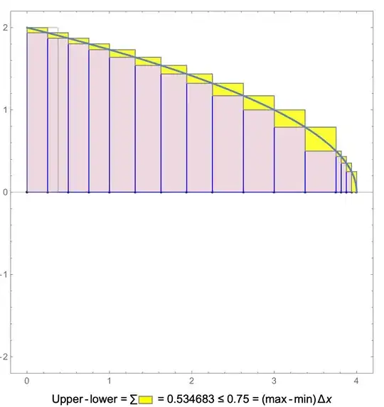

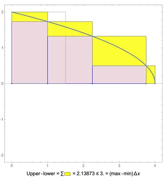

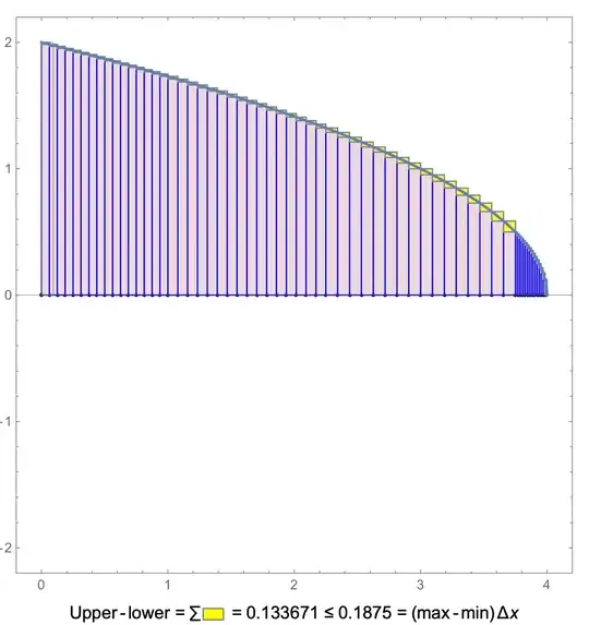

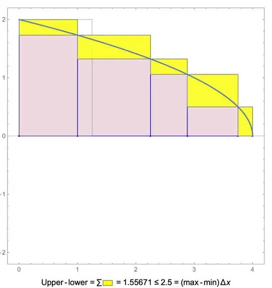

Addendum: On "little bits" arguments
Frankly, I think smart students question or doubt these arguments. For many, math has been taught in a way that to them seems bogus. They've learned to accept (and memorize) whatever the teacher says and use it as instructed. But face it: Nobody thinks the height of a little bit of a nonconstant graph is a unique and well-defined number. One end is higher than another. Whatever value you choose, you going to think that it's probably not exactly right but maybe it's close enough. Just like when making something and you need to cut something to a length.
But here's what one can show in calculus. First, there are bounds on how far wrong your choice of height can be: Each little bit has a maximum and a minimum height. When you sum up the little bits, there will still be an error. Again we can bound how bad the error, based on the minimum and maximum possible heights. Here is the key: No matter what the errors are, the worst-case error gets smaller if the little bits are divided into smaller bits; further, the worst-case error can be made as small as we please. It follows there is a unique number that the sum for anyone's choices for heights will get close to. That number is called the integral.
In the figures above (based on Newton's pre calculus book, Principia, Bk. I, Lemma III), the yellow rectangles show the difference between the maximum and minimum choices of the heights of the bits. The worst-case error is bounded by the sum of the areas of the yellow rectangles. The change the figure from the left to the right shows what happens if the third bit is divided. The large rectangle on the left becomes two smaller rectangles on the right. In effect, the large was divided into four, and two of the pieces were thrown away. As each bit is divided again and again, the yellow error bound get smaller and smaller:
One can also see the areas of the rectangles given by the minimum heights and maximum heights get closer to the area under the curve.
I guess it's difficult for math people not to give math explanations. But at least I put it in an appendix. And everyone knows not to read the appendix. But as I said at the beginning of the appendix, just saying, "Trust me, it works," contributes to the appearance of bogosity in mathematics.
