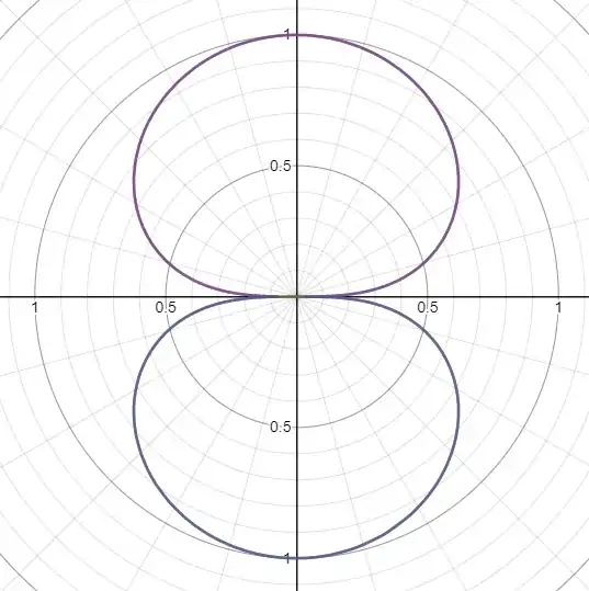

These are all great, but then there was a homework question about the graph given by $r^2=\sin\theta$.
It's clear that we can replace $r$ with $-r$, so we have symmetry number 3. Additionally, $\sin\theta=\sin(\pi-\theta)$, we have symmetry number 2.
The function appears to fail the test for symmetry number 1, because $\sin(-\theta)=-\sin\theta$. However, any function with two of these symmetries automatically has the third. (Together with the identity transformation, we're just looking at the Klein 4-group here.)
Symmetry number 1 can be detected algebraically, but to do so, you have to use the equivalent transformation $(r,\theta)\mapsto(-r,\pi-\theta)$, which is clearly just the composition of symmetries 2 and 3. Similarly, symmetry number 2 could also be detected by the composition of 1 and 3: $(r,\theta)\mapsto(-r,-\theta)$

The equation $r^{2} = \sin \theta$ has no solutions when $\theta \in (\pi, 2\pi)$.
The picture drawn in the question is wrong because negative values of $r$ should not be allowed. Those points on the curve with $r < 0$ do not correspond to points on the curve $$(x^{2} + y^{2})^{3/2} = y.$$ The curve should only be the top part of the curve indicated. Of the symmetries considered only the map - $(r, \theta) \to (r, \pi - \theta)$ (reflect across the vertical axis) is valid.
The map $(r, \theta) \to (r, \pi + \theta)$ is not a symmetry of the equation. If $\sin \theta$ is positive, then $\sin(\pi + \theta)$ is negative, and there is no solution. When negative values of $r$ are allowed, then $(-r, \theta) \sim (r, \pi + \theta)$ so, for a point $(r, \theta)$ of the curve with $r > 0$, the "solution" $(-r, \theta) \sim (r, \theta + \pi)$ is not a solution! Put another way, the equation $r^{2} = \sin \theta$ is not well defined on the quotient of $\mathbb{R}\setminus\{0\} \times (0, 2\pi)$ by the identification $(r, \theta) \sim (-r, \pi + \theta)$. The solutions with $r$ negative do not correspond to any points in the $(x, y)$-plane.
The two-lobed curve drawn in the question corresponds to the Cartesian equation $$(x^{2} + y^{2})^{3} = y^{2},$$ which corresponds to the two polar equations $r^{2} = \pm \sin \theta$. This curve does admit all the symmetries discussed in the question.

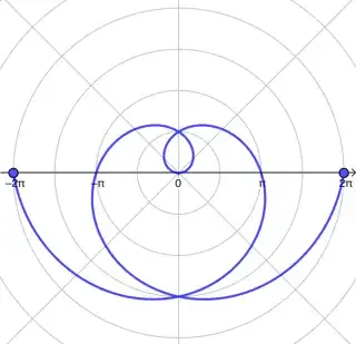

If a textbook gives symmetry tests for graphs of polar equations without stating that they are sufficient but not necessary, that's a glaring omission, in my opinion. I looked through several books, and I only saw this in Stewart and one other book. The rest either didn't cover symmetry tests or stated that they weren't necessary conditions. Larson seemed the most comprehensive to me. The book gives the following tests.
The graph of a polar equation is symmetric with respect to the following when the given substitution yields an equivalent equation.
  1. The line $\theta=\pi/2$: Replace $(r, \theta)$ with $(r, \pi-\theta)$ or $(-r, -\theta)$.
  2. The polar axis:      Replace $(r, \theta)$ with $(r, -\theta)$ or $(-r, \pi-\theta)$.
  3. The pole:               Replace $(r, \theta)$ with $(r, \pi+\theta)$ or $(-r, \theta)$.
Larson also gives two more "quick tests for symmetry."
  1. The graph of $r=f(\sin\theta)$ is symmetric with respect to the line $\theta = \pi/2$.
  2. The graph of $r=g(\cos\theta)$ is symmetric with respect to the polar axis.
The graph of $r=\theta+2\pi$ for $ -4\pi \leq \theta \leq 0$ is given as an example to show that these tests are not necessary for symmetry.
A graph of the polar equation r = θ + 2π between θ = -4π and θ = 0. The graph is symmetric about the line θ = π/2.
Maesumi gave necessary conditions in their answer. The equation $r=\theta+2\pi$ yields an equivalent equation under the substitution $(r, \theta) \mapsto (-r, -\theta-4\pi)$, satisfying Y2.
