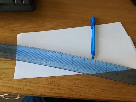

- Standard ruler
- Pen/pencil
- 2 strips of card/paper (just cut a standard piece length-ways down the middle)

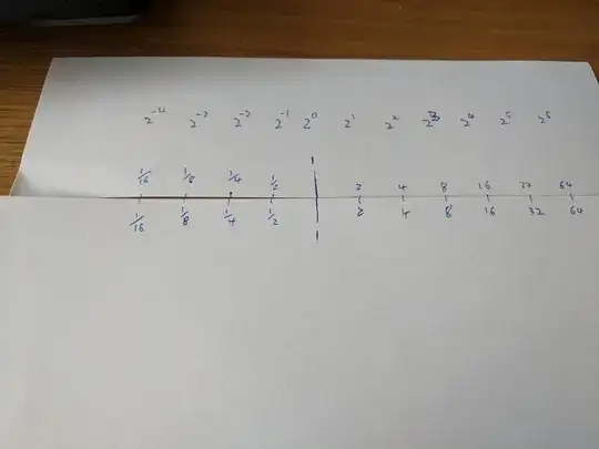

Flip your pieces of card over, and make a new set of graduated scale lines. However, instead of incrementing by one each time, multiply by some base. I use two. It is worth pointing out that this is a logarithmic scale and each entry is just the linear scale value, raised as a power of two.
I think it helps to make a larger mark for the $0$ line, and to write $2^n$ above each graduation.
Now perform the same operation as before, only as a multiplication. We will find $4 \times 8$. Line up the $1$ of the top scale with the $4$ on the bottom. Find the $8$ on the top scale, and then look at what it lines up with on the bottom. $4 \times 8=32$
Congratulations, you have now made a simple slide rule, and used it to demonstrate the first law of logarithms. The action that we performed is the same "addition" action we performed with the linear scales, but instead of adding, we ended up with a multiplication, because our scales are logarithmic.

I also do this! I would recommend labeling the picture differently -- label the "4" in your last image as "$log_2 4$" and the "8" as "$log_2 8$". Then the overall distance is "$log_2 32$"! – Chris Cunningham Apr 17 '19 at 16:28
Absolutely brilliant - I've long believed that logs are best introduced by starting with base 2 examples, and this only reinforces that idea. Also, if the project is too time consuming for students to each construct, not too tough to do this once and make photocopies. – JTP - Apologise to Monica Apr 17 '19 at 21:36
1As a first step to fill in numbers other than powers of 2, you can benefit from the fact that $2^{10}$ is very close to $10^3$. So if your slide rule is long enough to have a marking for 1024, just trisect the segment between that mark and 1, and you have a pretty accurate location to put 10. Then you can do 5, 20, etc. by multiplying by powers of 2. ("Pretty accurate" here means "no worse than the inevitable sloppiness of dong the whole construction by hand.") – Andreas Blass Apr 18 '19 at 22:00
