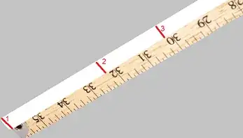

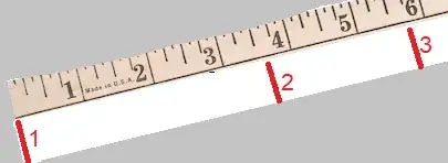

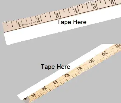

I have my college algebra students create slide rules each semester.
Key pedagogical question:
  • What is the point of having an algebra student construct a slide rule?
Possible answers:
  • The goal is to convince the students that things like $\log 5$ are real numbers. If you ask a student what $\log 5$ is, you often get the answer that it is a function, or a procedure, or even a question. Having students physically work with expressions like $\log 5$ could help them better conceptualize what the data type of $\log 5$ is [citation needed; and I have none].
  • It's neat. Show students neat things.
Materials:
  • Yardsticks (here yardsticks are actually better than metersticks)
  • Tape that is dry-erase
  • Dry erase markers
Prep:
  • Put tape on the yardsticks so that half the yardstick is covered but not the other half. The tape needs to wrap around covering both sides.
Outline:
  • Split the class into groups and give each group one prepared yardstick.
  • Ask half the class (the weaker groups) to put the yardstick so that "1" is on the left. They will make a mark on their yardstick labeled $x$ at the position $\log x$ feet for $x = 1, 10, 100, 2, 20, 200, 3, 30, 300, \ldots, 1000$.
  • Ask the other half of the class (the stronger half -- this is tricky) to flip the yardstick over so the "1" is on the right. They will make a mark on their yardstick labeled $x$ at the position $3 - \log x$ feet for the same values of $x$.
  • Then if you combine two of these sticks, you have a slide rule.
Key question to ask students:
  • How far is it from the end of the stick to the mark labeled "5"?
  • How far is it from the end of the stick to the mark labeled "4"?
  • How far is it from the end of the stick to the mark labeled "20"?
Key thing to emphasize from student answers:
  • $\log 5$, $\log 4$, and $\log 20$ are numbers.
Then of course show them that you can now physically see $\log 4 + \log 5 = \log 20$.
Then pull out the actual slide rule you brought in.
Then show them the clip from the movie Apollo 13 where the engineers frantically calculate with a slide rule.
